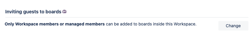

You're absolutely right that adding them from the Members tab would give them access to the entire workspace, and not something you want to do. Instead, look under the Settings tab, and you'll find a particular setting labeled "Inviting guests to boards":
I imagine yours is also set to "Only Workspace members", and you'll want to Change that to "Anybody". Doing this has no impact on any Guest's ability to see other boards, all it does is allow you to add non-Workspace members to boards, which is what you were initially trying to do. Once that's changed, you'll be able to invite those people!
