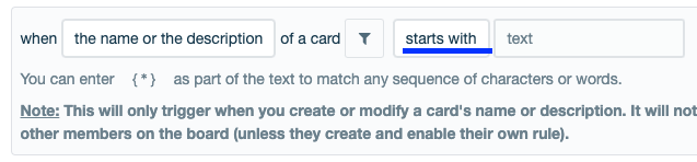

It seems in the Butler Bot days it was possible to have the Trigger simply be "when the name or the description of a card is changed", but that no longer seems to be an option and the closest I can get to it is this:
