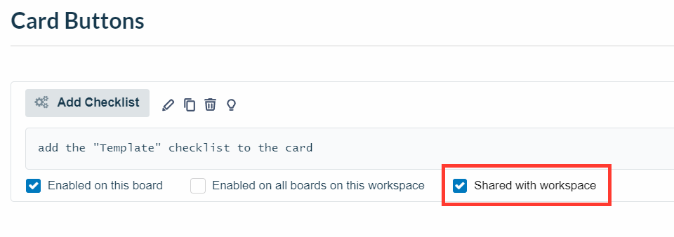

Hi @Susannah ! Welcome to the community :) have you checked the option to share the button with the workspace? Butler commands are created at the user level, so in order for others to see and use butler buttons, you need to share them.

Yes, this option is checked on my template.  I will check whether I've also done it on their boards - that might help!  I know I've checked 'enabled on this board' on all of them, which I thought would work.  It's odd that I can see the buttons and they can't though.

Hmm strange! As far as I know, if you have card and board buttons on your board, and these buttons are shared with the workspace, when someone copies the board, the buttons will follow through with the newly created board. Maybe try test with a dummy Trello account to see if you can recreate the issue?

Thank you so much to everyone who has taken time to help me.  I think the 'shared with workspace' tip was the answer, becasue one of my users has reported that her buttons have appeared this morning.
