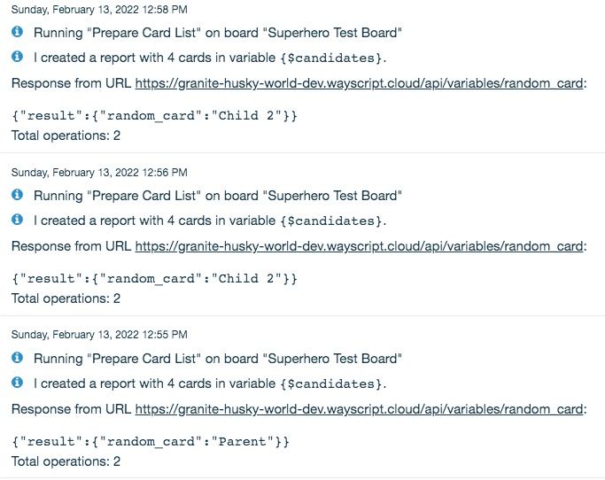

@Tom S.O.A.P.
Something like this (I used cardname to make it more readable):
