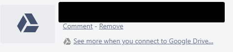

I've been experiencing inconsistencies with the Google Drive Power-Up. Sometimes documents and links appear like I expect, but other times I'm prompted to "See more when you connect to Google Drive."
I do have two Google accounts associated with my single Trello account*, but nothing happens when I attempt to "sign in" with either account.
This is an inconvenient but intermittent issue. I have not identified a particular pattern. It does affect me in both Trello in the browser and in the windows app.
Help?

I had this problem as well, and narrowed it down to a Chrome extension - something that was blocking the sync happening.
I went through all my extensions and turned them all off, then turned on one at a time and refreshed the trello board until I found the one that was causing the problem! I think it was an ad blocker or something like that because it stops cross site logging/tracking. I turned them all one and whitelisted Trello on all of them and I haven't had the same problem. However, whenever Chrome updates I have to whitelist Trello again on all the extensions, but now I know what I'm looking for it's relatively easy

It took me ages to find out how to do it! I use uBlock Origin, Privacy Badger and a number of others, and I've had to whitelist Trello on all of them to make sure that they 'talk' to each other!
I always know that if I see 'Connect Google Drive to see more' that one of the extensions has updated and I need to go into all of them and whitelist Trello again!

@Esme Crutchley alas it appears that the issue goes deeper than extensions. I whitelisted, tried disabling all of them, and even tried another browser to no avail. I'll be turning to Trello help next. Thanks for the tips, though!
