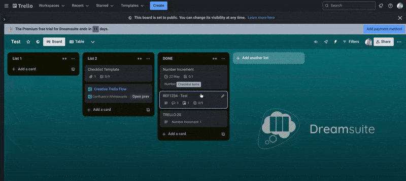

It can be done. You just have to manually type the field name in the set custom field to value action.  See the example below:
Mahmoud Bahr May 13, 2024
Hi @Mike - Dreamsuite Consulting
Thank you so much, it worked.
