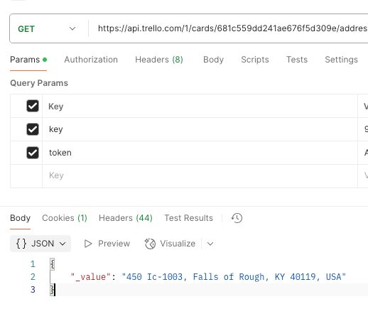

If you are using http request,  {httpresponse} variable if the api executes correctly.
https://api.trello.com/1/cards/681c559.....5d309e/address?key=9e3.....e98&token=ATTA1...
Based on the the variable would be {httpresponse._value}. You need test it out on your actual automation as this is just using POSTMAN
Screenshot 2025-05-08 at 2.59.32 PM.pngBEF8E
