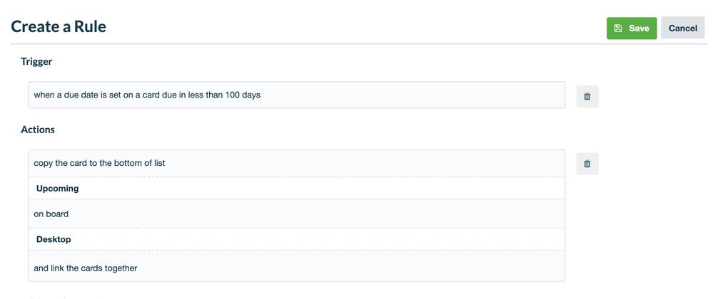

I have a 'desktop' board that everything feeds into, meaning that anything I need to know about on any of my boards (I have a few) comes into one place.
I run a Butler command for 100 days (I like to be prepared!), it looks like this:

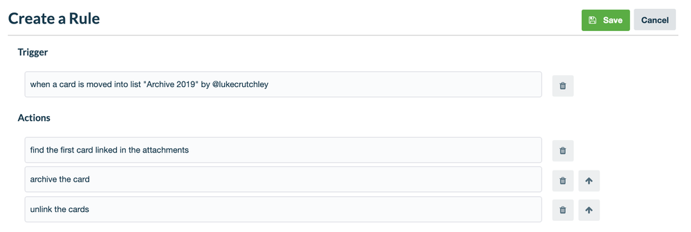

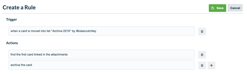

So with that in mind, this is what I would have something like this (remembering that I don't have a 'done' list, I have an 'Archive 2019' list):

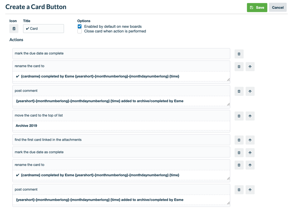

Screenshot 2019-11-18 at 20.58.22.pngAt the end, where it says archive the card, you could have 'move to done' - as long as you have a 'done' list on the individual boards. You could also have something that looked more like this:
Screenshot 2019-11-18 at 21.01.10.pngSo if you wanted the cards to stop being related, this is how you could separate them.

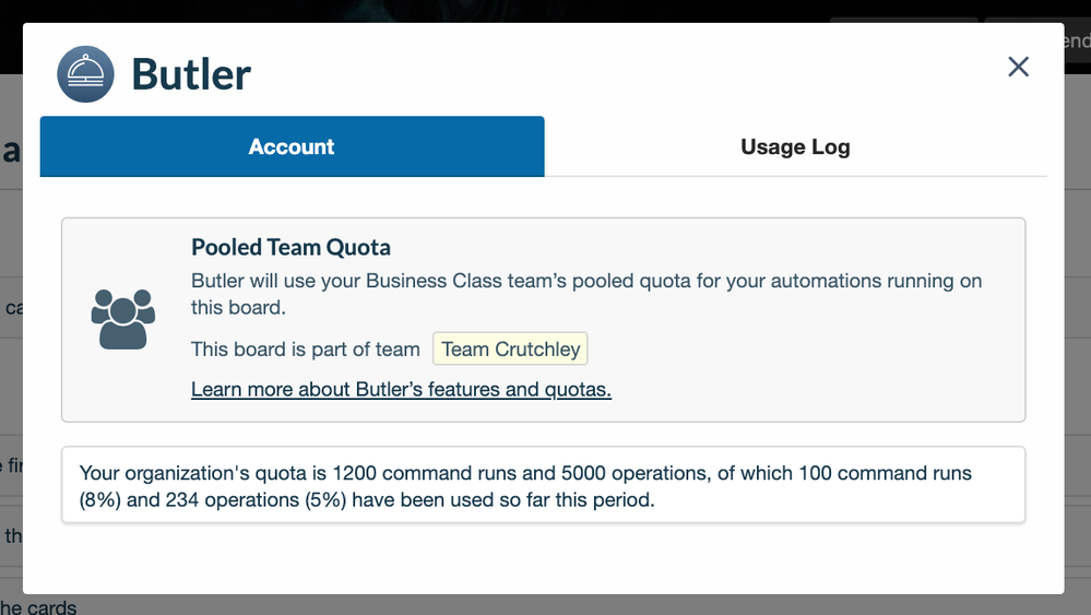

If you're ever unsure on how many Butler commands you've used and what's taking up what, click on Butler on any board, bottom left has 'Account' if you click on that you'll get a little box like this, which shows you how many you've used and an approximation of how much you've got left. That's when I knew I needed Business, because I'd run out!
Screenshot 2019-11-18 at 21.56.24.pngSo it breaks down what you can have, so a command run is basically a trigger, and the operations is everything after the trigger that you get it to do. I only have 1 person in my Business Class, so I have the lowest it's possible to have, but on my personal account I also get Trello Gold (which, being truthful I never use because of the limitations!). But I thought it might be useful to show you where you could find it, because they can rack up really quickly and it's perfectly possible to find that commands aren't running and you didn't realise and because they're not running, things aren't where they're supposed to be! So, from personal experience, keep an eye on that screen!
More than happy to be helpful in the future if you need me :)
Esme Crutchley
November 18, 2019
So in this example, I have 1 command (the click of the button) and then 8 operations.
This quota is taken out EVERY time you run a Butler Command, click a Board Button, Click a Card Button, every time a calendar command runs, and every time a due date command runs, so in the beginning, be careful about what you run and when!

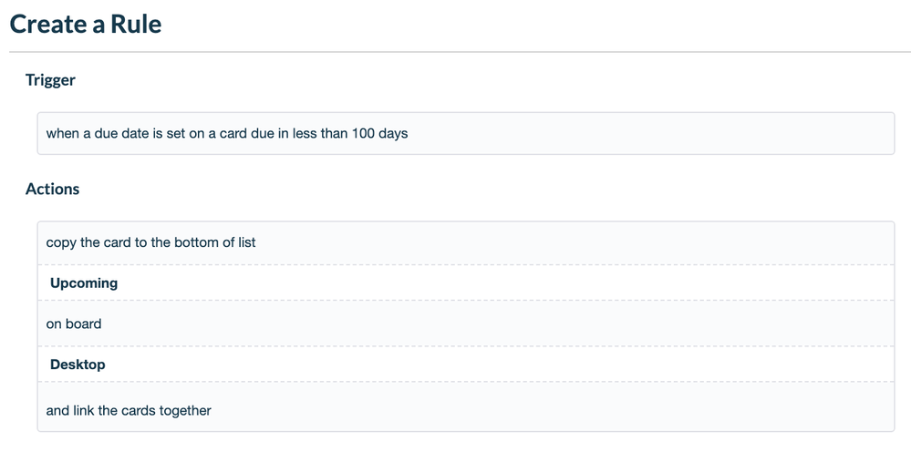

Let's start with getting cards from other boards into the 'Desktop,' which looks like this:
Screenshot 2020-01-05 at 17.10.13.pngObviously, you can change it to 30 days where mine is 100 (I just like being prepared!).
So that gets the cards INTO the 'Desktop' through a rule and into the Upcoming list.

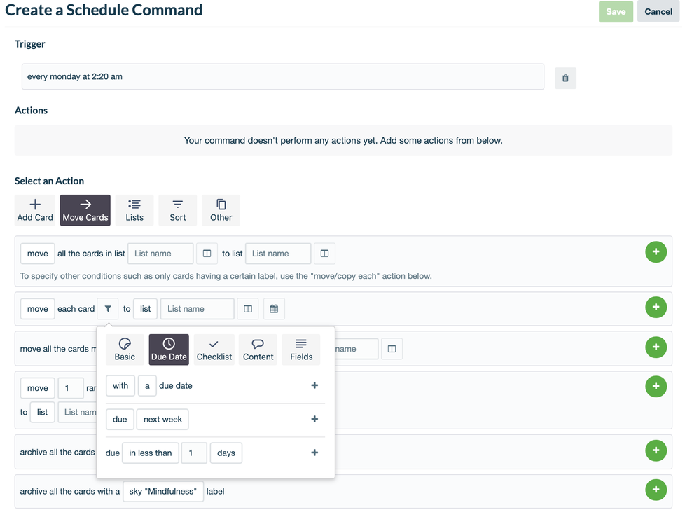

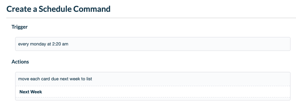

Then we need to organise them into their due dates using a calendar command.
To get cards into 'next week':

Screenshot 2020-01-05 at 17.13.20.pngMake sure that the 'this week' and 'next week' commands happen BEFORE the daily one, otherwise the 'today' tasks will pop back into the 'this week' list - not helpful!

Just to clarify -
The 30 or 100 day rule needs to be enabled on ALL other boards you want feeding into the 'desktop'
The 'this week' 'today' and 'next week' need to be enabled ONLY on the 'desktop' board
Sorry, just realised that I didn't explain that properly!
Esme :)

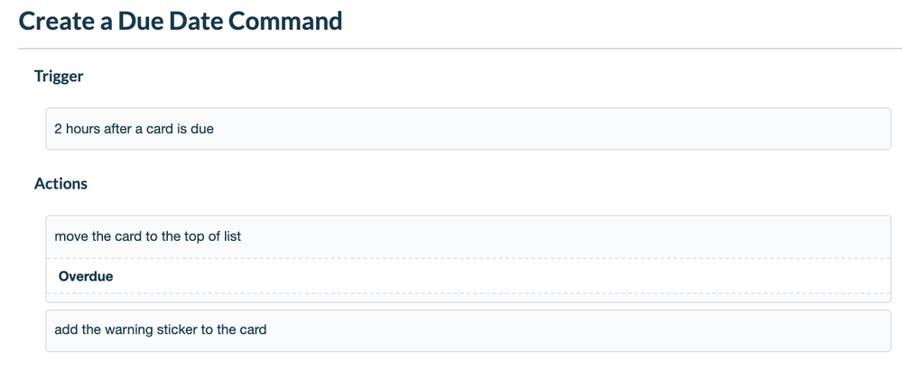

Esme Crutchley
January 5, 2020
To get the overdue cards moved over, this is the due date command that I have:

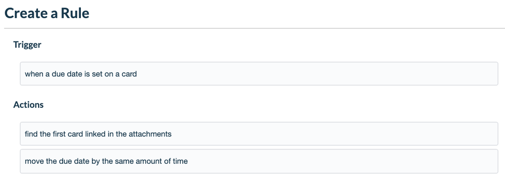

Esme Crutchley
January 22, 2020
Hi @JC
Ok, on the original board (where you copied the card from) provided that you linked the cards when you copied them, you can have a rule like this:
Screenshot 2020-01-22 at 18.00.06.pngThat should move the original card due date to the one you've just created *cross fingers*

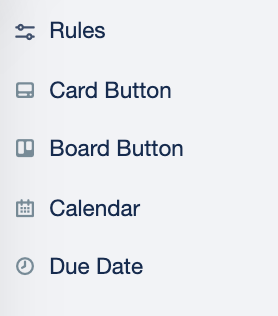

Esme Crutchley
June 7, 2020
Yup Derrick, everything on the left hand side is a Command:
Everything you add underneath it, is an operation
