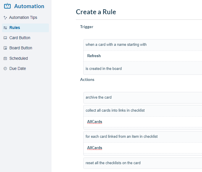

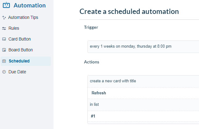

There's an Automation button in the top right of the screen. Scheduled automations are pretty flexible in how you want to set up the intervals. But they don't have access to the unchecking commands, which are under Rules automations. So you have to set up two separate automations, one that triggers according to a schedule, that then triggers the second Rules automation. A bit convoluted but it works.
Notes:
- I just chose an overly complicated schedule to show you can.
- I also just chose Refresh as a random name, feel free to set it to something that you'd never name a card by accident.
- #1 refers to the first list in a board, could be replaced with any list name, but it doesn't really matter because you immediately archive the card and hide it away anyways.
