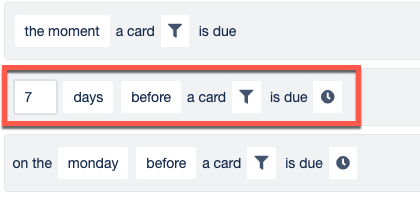

Hi Jessica, welcome to the Atlassian Community! I hope you're enjoying Trello.
The reason why the rule worked on the same day but not before is that the "due in less than 7 days" part is just a filter, but the rule is triggering the moment a card in the list "To Do + kaufen" is due.
We use the filter to specify details about the card so that it won't run the rule on cards you don't want to change. For example, if you want to run the rule only on cards assigned to you, you can use the filter "assigned to me". The filter used in the rule you mentioned wouldn't make a difference because at the moment a card is due, it will be already due in less than 7 days, this is why the automation just ignored it and ran the rule at the moment it was due.
I think that the trigger you're looking for is this one:
Please note that if a card is already due in less than 7 days, the rule will not work. If you have cards due in less than 7 days and want to move them to a different list, you can consider creating a board button to move all of them at once. Here's an example:
Let me know if you have any questions and I'll be happy to help.
Hi Corolina,
thank you for getting back to me.
I used exactly the filter you suggested but still the cards aren´t moved.... I used an "extra" filter for a specific list:
7 days before a card in list "To Do + kaufen" is due, copy the card to the top of list "Lagerverkauf / Aktionen" on board "M Akute Aufgaben",
As far as I understand your explaination the trigger will ONLY work if the due date is exactly 7 days away... everything else inbetween won´t trigger it right?
The button for the board is a good idea but we would like to have it automatically taken place because it is an extra thing to do and which someone has to think about acutally doing if you know what i mean.
Thank you for your help.

Hi Jessica,
If the automation isn't triggered 7 days before a card is due, please create a ticket with us informing the card URL, date, and time that the automation should have run so we can investigate further. You can find our contact form here: https://trello.com/contact
I know the button would be a manual action, and it's not what you desire, but it will only be used once for the existing cards with due dates less than 7 days. The rule will run at some point for the ones with more than 7 days.
If you're worried about new cards that are created on the board with a due date less than 7 days, you can also create a rule like this one:
when a due date less than 7 days from now is set on a card in list "To Do + kaufen", copy the card to the top of list "Lagerverkauf / Aktionen" on board "M Akute Aufgaben"
For cards that are copied into the board with a due date, a rule like this one should work:
when a card due in less than 7 days is added to list "To Do + kaufen", copy the card to the top of list "Lagerverkauf / Aktionen" on board "M Akute Aufgaben"
