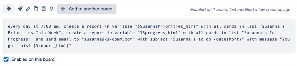

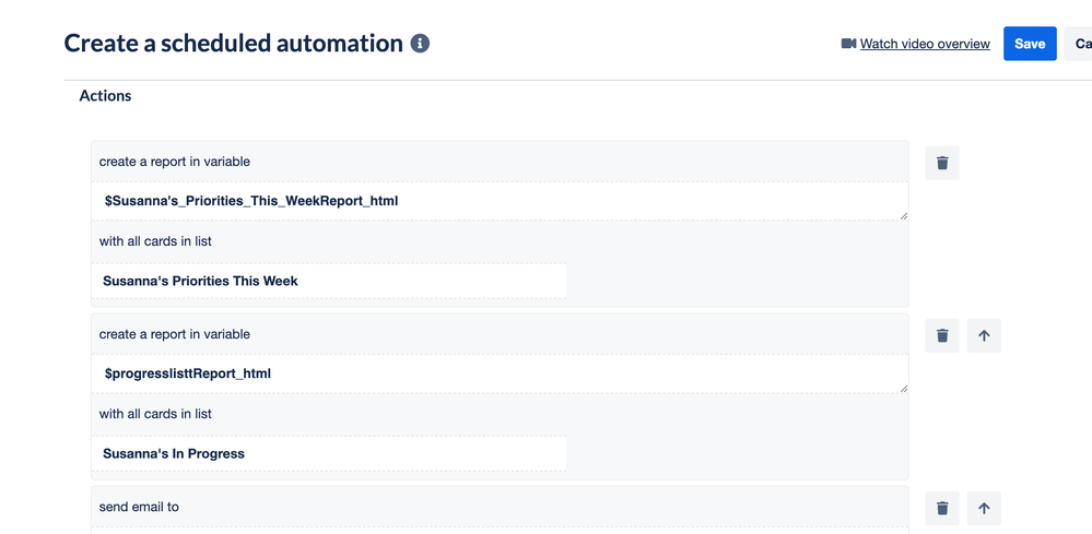

Here's the code I have, showing two different formats I tried -- neither of which worked.

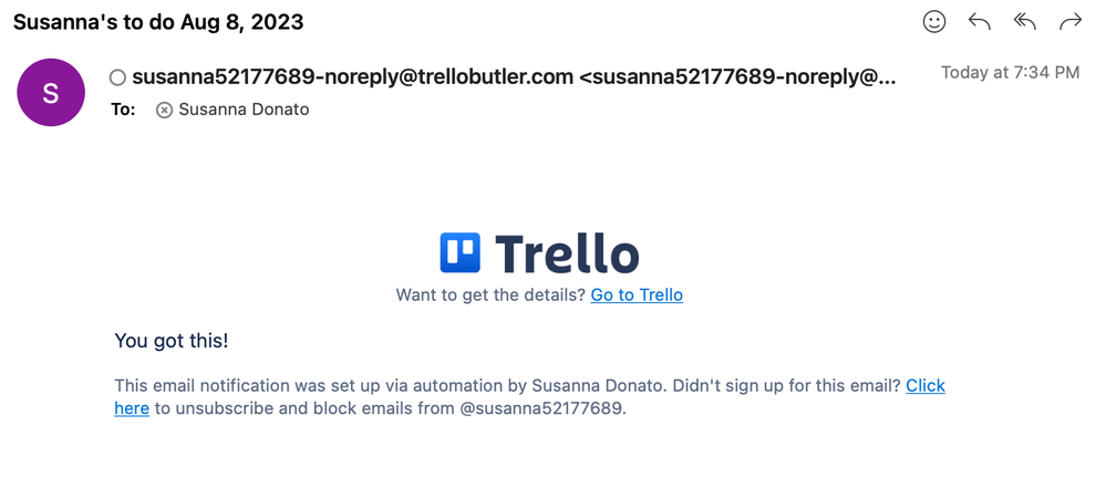

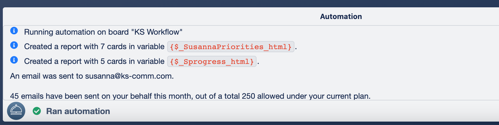

Thank you! I did look at that guide, but maybe the piece I am missing is how to create the variables. I re-wrote my variables without special characters or spaces and then again with the _html that I saw referenced in another similar question. The automation report says it pulled 7 cards in one list and 5 cards in another list, but I still get an empty email with either format.
Where am I going wrong now? Appreciate the help!

When creating an automation report, you'll first need to create the report variables with plain text.
Then send a visual email and include each of report variables you've created {$reportvariable_html}
Based on the automation you've set up so far, you'll want to make changes to the email message, so it can look something like below:
