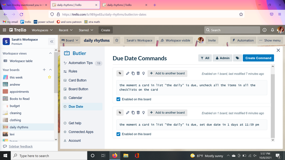

@Iain Dooley thank you SO much for replying on here. I'm working with the help center for trello, but so far no solution. I added a screenshot of the commands I have right now. I know these two can be combined, but I had separated them in the hopes that it would work correctly. But no. I have tried so many different combinations and commands, and they all consistently work if the due date is not checked and don't work if it is. The person from trello help suggested I do a command that involves "with a complete due date" in the command, which I really thought should work, but that didn't even work. I would love to hear any advice you have. Thank you! Sarah
@Sarah Watkins yep, you're right, it doesn't work. This seems like a bug to me because the fact that there is an explicit filter for taking action on a card with a complete due date, does certainly suggest that you should be able to do it.
