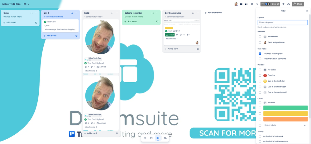

  1. Filter by cards complete or not complete (top tip, hit the F key from anywhere on the board to bring up the filter list)

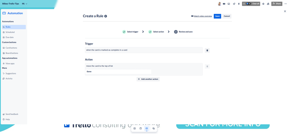

  2. Create an automation so that when you check a card as complete, it moves it to a Done list:
