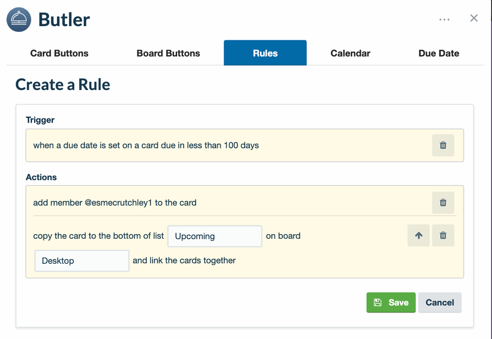

I use a Butler 'rule' for this. I have a 'desktop' board that's always open and everything feeds into here. I have a command set up and enabled on all my other boards, so that when a due date is coming up, the cards get copied into my board and then linked together, so that I know the task is due and where it came from.
I have this rule enabled on EVERY board that isn't my 'desktop' - doesn't matter what the other boards are, whether they have due dates or not. I do this just in case I randomly set a due date on a card on a board that doesn't ordinarily feed into my 'desktop' and that way I know I can set due dates anywhere I like and they'll always feed in where I live (my 'desktop' board)
It looks like this. Please excuse the fact that I have mine set up for 100 days! I use it for birthdays and things like the car insurance/service/mot, so I like to be prepared well before time!

Apologies for the delay in responding. I wanted to try it out first before feeding back. So this is excellent! It worked....as complete beginner took me a bit of time to just work out how to set up the rule etc. But in principal it worked - I am very happy.
What I need is for it to self generate a to do list.
So I set it up to put any new task with a calendar date of three days to appear in the desktop board - with an assigned colour.
However, I discovered that it doesnt sync back. If I delete or archive or anything in the desktop board the original boards remain the same.
Then, I am now wondering/hoping that once other dates get closer they would appear. But I am suspecting the rule may only apply to new cards. Any suggestions as you are a butler guru!!!

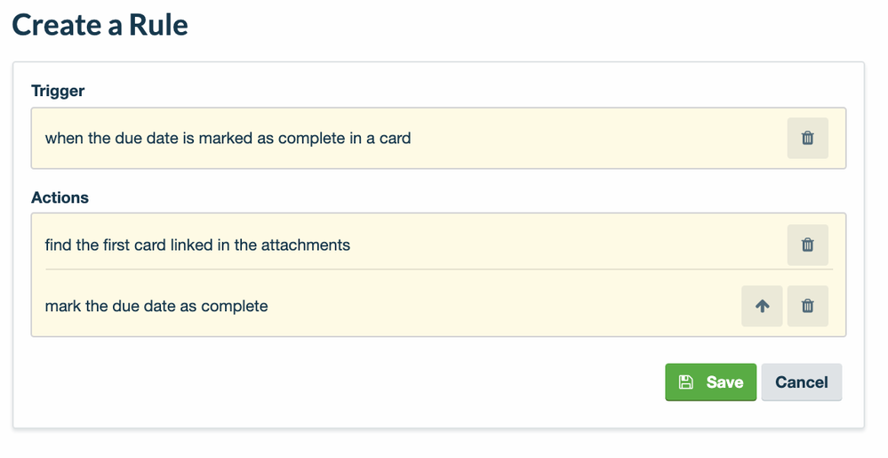

Hi Caroline,
Thank you so much for your kind words.
Okey dokey, let's do this!

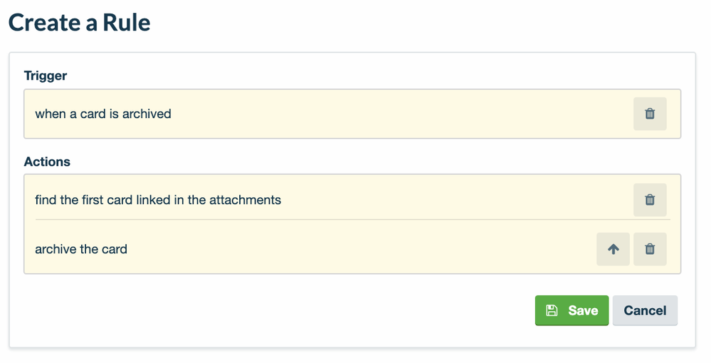

Right - this can be sorted with yes, you've guessed it, another Butler rule! This rule needs to be set up on your 'desktop' board and it can ONLY work if you have linked the cards together. If you haven't, you can adjust your original rule to link them and if you get stuck, I can help with that as well!
So, on your desktop board, you need a rule that looks something like this if you're using the archive function:
Or something that looks like this, if you're making the due date as complete:
When considering due dates, I've had a bit of trial and error on this, and while there is literally no finesse in this, it works! Go to all the cards that have a due date, remove the due date and set it again. That's the only thing that I've found works! Because it only works on due dates that are ADDED to cards, not ones that are already there, so the easy hack is to remove them and add them straight back! However, a word of warning, if you get the due date wrong, it will automatically add the card to the 'desktop' board for the first date and then again for the right one! All you need to do in this case, is archive the card on the 'desktop' board that's the wrong date, because the right one should still be there.

Ok you are a genius! It worked - the archiving rule!

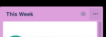

The native way to do it (without setting up a Butler command to do it for you with one click), clicking on the 3 little dots at the top of each list that you want to organise by the due date:

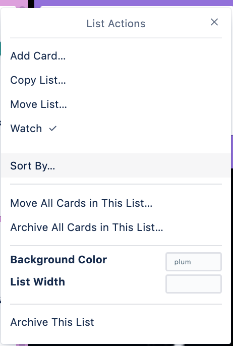

Then clicking on 'sort by'

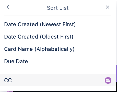

Then select 'due date'
And voila!

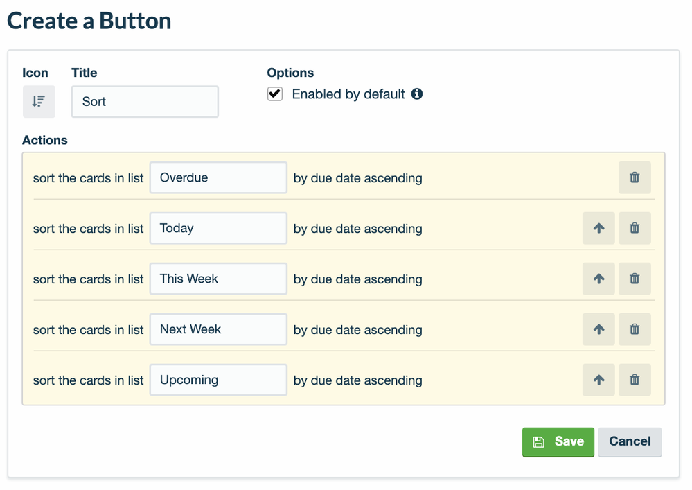

As I said, I have a Butler rule for mine, because I have a LOT of lists on my 'desktop' board and want to click 1 button not a million lists, so my Butler board button looks like this:
This is the icon that appears in the top right-hand side of my 'desktop' board (on the same line as Butler and Calendar and things like that), and the mechanics behind it look like this:
So my board button sorts all the lists that I've added without me needing to do each one individually.
Notice that this is a board button and not a rule. They're set up in exactly the same way, but there's no trigger, so it's not an 'if this happens then do that', it's literally a list of things you want to happen when you click the button.
