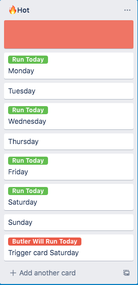

@kraeMit I worked on this just for fun. I doubt anyone would want to implement this but it works
every day at 5:00 am, create a report in variable "run_days" with all cards in list "🔥 Hot" with the "Run Today" label using pattern "{cardname}^{weekdayname}", post to url "https://25368.wayscript.io/test?registry=None&module=None" with payload "{\"card_id\" : \"5f81a53052ba3b7d2f718666\", \"report_variable\" : \"{$run_days}\"}", and send an email notification to "li....hss@gmail.com" with subject "Is a match found?" and message "If match is found the result will be the new Trigger Card name : {httpresponse.output}"
I have a list with cards named Monday through Sunday. Those days I need to run, I will have a label "Run Today" set. Pass the report variable via Butler Http to an endpoint that company the card name with the {weekdayname}. Send email to myself to see results (testing purpose only)

if there is a match change the Trigger card name as a way trigger the processing you need. It can be other ways.
when the name of a card contains "{weekdayname}", add the red "Butler Will Run Today" label to the card
Above is based on technique I developed. More details are available on Extending "A Powerful Combination" post.
Below is a picture of the list.
