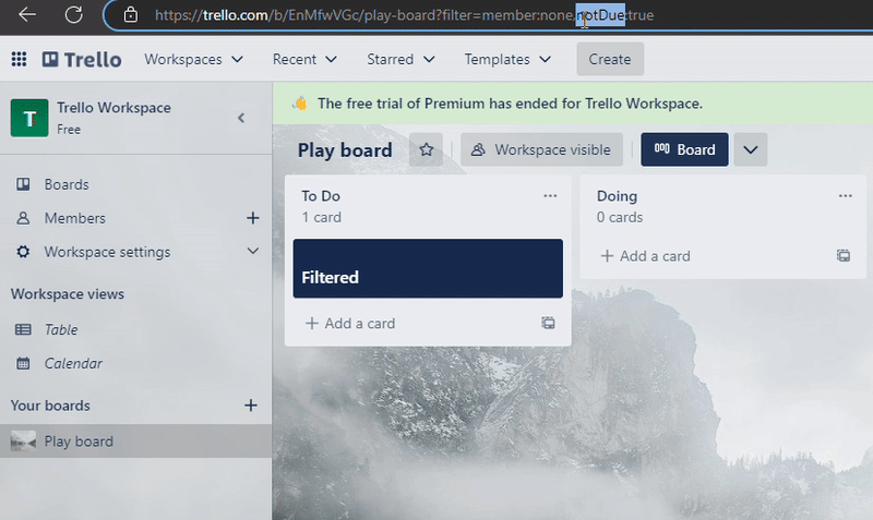

Okay, so with automation you cannot create a filter button but how neat would that be if you could??? (I'm looking at you Trello peeps 😉)
One neat trick you can do, filters actually have their own address so you can copy the address from the title bar of your browser and paste it into Trello, which will turn into a board link.
You can set the card title of the cover card (in black) to describe the filter, e.g. "Assigned to me"
Here it is in action
