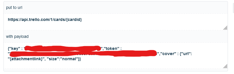

I am trying to copy the cover from one card to another using Butler HTTP requests. I was able to set the colors this way but when I tried setting the cover like this : Screenshot 2022-04-10 235023.png
It gives an error:
Since the file is already uploaded to trello shouldn't this be an allowed image service?
Is there any way I can set the cover? Is it possible by getting the attachment id? If so how?

As per the REST API documentation for the Update a Card endpoint, if you want to refer to an image using the url parameter, you can only refer images that are hosted in Unsplash for the cover:
url. Used if making an image the cover. Only Unsplash URLs work.
Urls to any other image location / place are not allowed.
To use an image that's attached to any card as the cover for any other card, you have to refer to it by its ID:
idAttachment. ID of an attachment on the card. Used if setting an attached image as the cover.
However, Butler currently does not have a variable such as {attachmentid} that will return the ID of an attached image, so there is no way to automate that aspect of the rule.
You are essentially stuck with having to manually put the ID of the image into your HTTP PUT request in your Butler rule:
{"key" : "[api_key]","token" : "[api_token]","cover" : {"idAttachment" : "ABCD1234etcetc","size" : "normal" }}

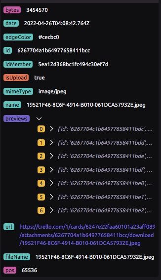

I don’t work with native Trello api a lot but based on your post, the issue is not the setcover but you did not get a image file as you indicated.
I am able to get this if I make one of the attachment as a cover vs a cover that is taken from the unsplash. Same results when I used the python library and native api call.
Do note the url structure.

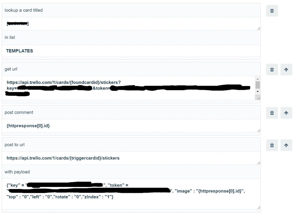

I mean. I created the custom sticker. I do get the expected results from the get request (I put it in a comment to ensure there was something usable) but when it comes to the POST part, it gives me an error:
400 Error parsing body
This is the workflow.
I tried with httpresponse[0].image too, just in case but it has the same effect.

I think you need to more closely read the information that is being provided.
I've already advised that you can't put {httpresponse[0].id} in a Put request's payload, because it gets parsed as ordinary text, hence the 400 Error parsing body error you got.
You have to actually type in the id of the sticker, directly into the payload:
{"key" : "123456blahblahblah","token" : "123456blahblahblah123456blahblahblah","image" : "627ca47368c7537ba17b6ec5","top" : "0","left" : "0","rotate" : "0","zIndex" : "1"}
.... as per the example I provided.
If you don't want to manually type in that information into the payload, you have to put the sticker's id in an intermediate custom field, then use that custom field in the Put request payload:
{"key" : "123456blahblahblah","token" : "123456blahblahblah123456blahblahblah","image" : "{{%custom_field_that_holds_the_sticker_id}}","top" : "0","left" : "0","rotate" : "0","zIndex" : "1"}
 .... as described in the initial suggestion I provided.

Thomas May 12, 2022
Sorry @Sunny Ape I'm not a native english speaker nor a good programmer and I sometimes don't understand everything.
After messing a bit around with all the info I finally got it. I just had to substitute the sticker id with the sticker image.
