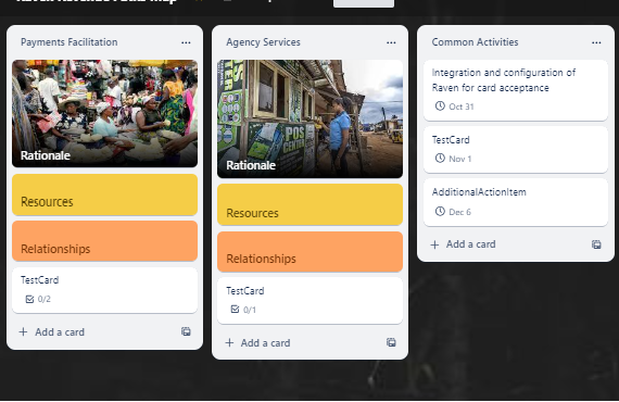

I have a board that has Two cards with the same name on the first 2 lists as shown in Board Snippet1.

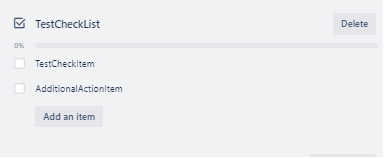

Each of the two has the same checklist on them as shown in Board Snippet2.
I want to be able to set the Completed Status on a card with the same name in Board Snippet1.

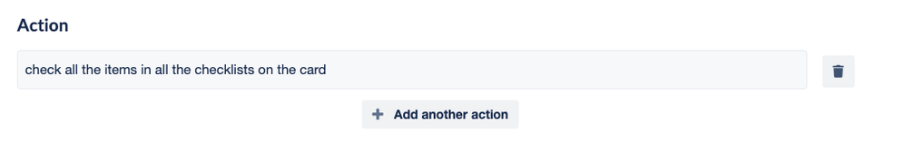

Could you use the check all the items in all the checklists of a card action?

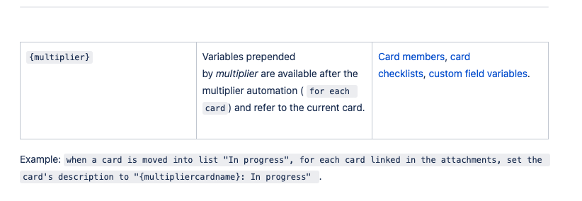

I will say that i think you're looking at using the multiplier concept, which i haven't used yet.
You can learn more about it here!
