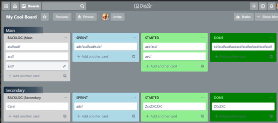

Yes, the Trello Clean Chrome extension works well, but you can gain more customization using a CSS injector and swimlanes.  Here's my setup:
  1. User JavaScript and CSS [1.2.8] by tenRabbits.
  2. Swimlanes for Trello [1.7] by Jess Yaus.
Install and activate the extensions, then set up your lists and swimlanes:
  • Append "|swimlane-name" to the first list.
  • Append "|swimlane-name: to whichever lists start a new swimlane.
  • Add CSS to color the list backgrounds and hide the "Add a list" item.
Sample CSS for four lists per swimlane:
#board > div:nth-child(5n+1) > div { background-color: lightgrey; }
#board > div:nth-child(5n+1) > div > div.list-header.js-list-header.u-clearfix.is-menu-shown > textarea { color: black; }
#board > div:nth-child(5n+2) > div { background-color: lightblue; }
#board > div:nth-child(5n+2) > div > div.list-header.js-list-header.u-clearfix.is-menu-shown > textarea { color: black; }
#board > div:nth-child(5n+3) > div { background-color: lightgreen; }
#board > div:nth-child(5n+3) > div > div.list-header.js-list-header.u-clearfix.is-menu-shown > textarea { color: black; }
#board > div:nth-child(5n+4) > div { background-color: green; }
#board > div:nth-child(5n+4) > div > div.list-header.js-list-header.u-clearfix.is-menu-shown > textarea { color: lightgreen; }
#board > div.js-add-list.list-wrapper.mod-add.is-idle { visibility: hidden; }
 NOTE:  Beware the line wrapping!  Every new line above starts with a hash (#) mark.
Looks like this:
