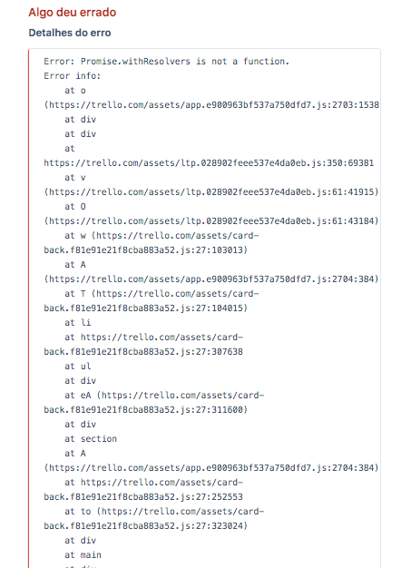

Tentei e apareceu o mesmo erro, irei enviar aqui o erro.Captura de Tela 2025-08-08 às 13.44.52.png

Can you confirm which browser, version, and device you are using? I have seen this issue occur when using a browser version that we no longer support.
Support was dropped for some end-of-life browser versions, including Safari 16, which reached end-of-life last year. We have also dropped support for Safari versions 17.3 and below.

Estou usando o chrome: Versão 116.0.5845.187
No macOS High Sierra: Versão 10.13.6
iMac (21.5-inch, Mid 2011)

The version of macOS that ships with v16 reached end of life last year. All actively supported versions of macOS should support v17, and version 10.13.6, which corresponds to macOS High Sierra, is an older version and this what mostly causing the issue .Can you try accessing your account from a different device? Do you encounter the same issue?
