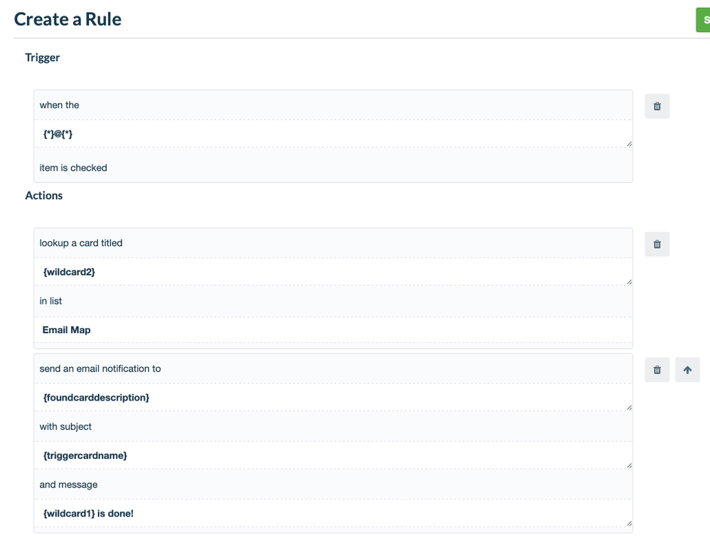

But here is something else maybe you can help with. We are a property management company. We have a trello list set up for each property. So when it sends the email when the item is checked off, is there a way for the email to show the card name that it came from, in our case the property? The notification shows the property name, but those go away in a few weeks. We bill our owners once a month for items like the propane tanks. So the emails are a better way to keep track of those times.

@Steve Hmm. You can use Butler to send emails to a fixed email address, or to members on the card, but AFAIK you can't use Butler to send emails to an email address mapped by username, so you'd have to have your emails stored in a way that mapped username to email.
So if you created a list called "Email Map" and then add cards named with the member/username and with the email address of that member in the description, this works to send them an email notification with the card title and checklist item in it, instead of posting a comment:
Try using a wildcard as part of the checklist item name and then add that to a comment action.
Update : wildcard will not work but, it seems that with another person is mentioned in the item, that person will receive a notification when item is checked. I did a simple test but you should verify it.
