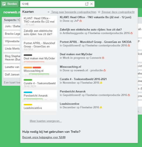

The search box keeps popping up on different, unwanted occassions. It always uses the same search term: "12:00" (which is a time I use a lot for deadlines).
It pops up (seemingly) at random in the main search field, but also when I try to put a label or a user on a card.
Check out the 2 screenshots below. I'm using the latest version of Chrome.
Anyone any suggestions? Thanks!
Torben_trello
June 19, 2017
Looks like this field might be auto-filled automatically with a time. Do you have a password manager like LastPass or 1Password enabled? If so, can you disable it, remove the entries for Trello, or set the auto-complete for the entries for Trello to off?
Jeroen van Putten
June 22, 2017
Hi Torben, thanks! I think that did the trick. I disabled the auto-complete for Trello-pages in LastPass earlier this week. And no problems since than.
Thanks for the help!
