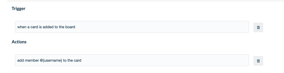

@Jessica Bolts hi there! welcome to the community! and yes, you'll need to use a butler variable to reference the person who did the action, to be added to the card. (Join refers to you, the person who built the automation, not the person triggering the action.)
Specifically you'll want to use {username}. Should look like this:
I've been trying to get this sorted for ages, thanks Brittany!
