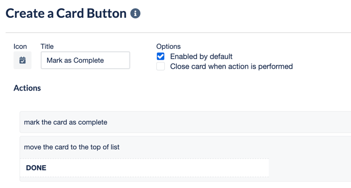

I'm not sure if this is helpful as it won't be a scheduled automation, but a workaround I can think of is using a card button that marks a card as complete and also moves it to the top of the list "DONE" like this:
Other than that, the workaround you have already would be the best option for you. You might also want to consider getting a Standard so you can increase the automation quota:

The second workaround you suggest - for "moving a card to the top of the DONE list, WHEN it is marked completed" - that can already be done with the current supported automation rules: "when the card is marked as complete in a card, move the card to the top of the DONE list", which will move the card as soon as it's "marked completed" action is triggered.
For my use case, I don't want to move the card immediately on marking completed, but at the end of the day, hence need a way to apply a filter to select only completed cards independent of any other action.
