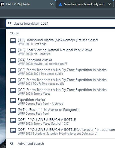

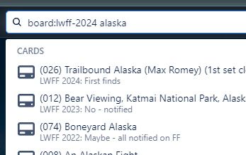

I know this is a post from a while back but I'm trying to clarify something. Maybe you can help.
I have multiple boards. I am trying to create a search that will search for a keyword in the title of a card LIMITED to a single board - not all of them.
For instance I was trying to search fo 'alaska' in a card name but cannot find out how to make it limit to a certain board - LWFF-2024 in this case
I have tried
board:LWFF-2024 alaska but get results from all board as show below.
I have also tried board:LWFF2024 alaska and board:LWFF 2024 alaska thinking it may not recognize the Board name.
It seems like it would be simple but I'm not seeing my error. It happens in advanced search as well.
Thanks.
@Steve it looks like your board is called "LWFF 2024", there is no hyphen in the board names according to your screenshot. In order to constrain search results to a single board with a name containing a space, put the board name in double quotes:
board:"LWFF 2024" alaska
