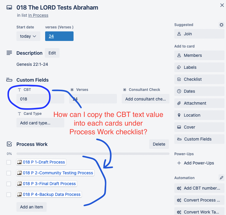

Show can I copy the custom field value into other cards with checklist links
Philippe Gallant March 18, 2022
I tried to use this command when I created a button:  for each card linked from an item in checklist "Process Work", set custom field "CBT" to "{{%CBT}}". it is not working.   Need your assistance on this.  Thank you!
Philippe
Hannah Humbert - Simpla Workflows
March 18, 2022
Hi @Philippe Gallant ! Welcome to the community :) you'll need to use the {customfieldvalue} variable in your rule. Just be careful of looping - I'd suggest diffirenciating the "trigger" card vs the "action" cards by adding a condition to your trigger. E.g.
when custom field "CBT" is set in a card in list "Trigger", for each card linked from an item in checklist "Process Work", set custom field "CBT" to "{customfieldvalue}"
Thank you for your quick reply.
OK, will this copy 018 at CBT text value into each card under checklist links?
March 18, 2022
Yes, should do! Is it not working for you?
I tried this rule: when custom field "CBT" is set in a card in list "In Process", set custom field "CBT" to "{customfieldvalue}"
In the card where the checklist is and I entered 018 and the checklist where the cards are didn't add 018 on each card.
@Hannah Humbert - Simpla Workflows I tried to use the card button with this command: for each card linked from an item in checklist "Process Work", set custom field "CBT" to "{customfieldvalue}"
This didn't work as well.
I will be away for the evening and I will try again tomorrow or next week.  Thank you for your help.
March 20, 2022
@Philippe Gallant In the example I gave above, the trigger is based off a custom field value change. I believe the ability to copy a custom field value only works if the CF value was involved in the trigger, AFAIK, it won't work if the trigger is a button.
