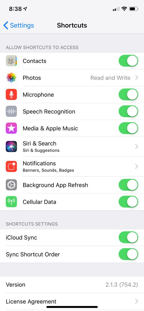

This doesn't happen to me, that's so weird! Mine prompts me to tell Siri my message and then converts it to a Trello card. Can you make sure you have all of these turned on in your Settings? (Settings app > scroll down to the Shortcuts app)
You know what, I think I just had a setting off b/c I was not familiar enough with shortcuts yet. I tweaked it a little bit earlier this week and got it working now!
