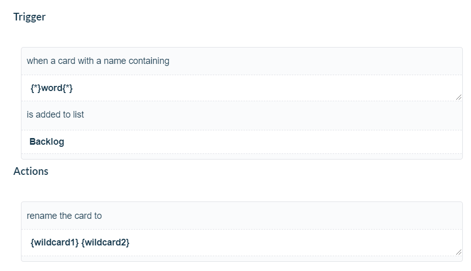

Hi @Ayden Heinig ! Welcome to the community :) would this work for you?
Ayden Heinig January 24, 2022
I don't believe so, my point is not to rename the card but to remove the card from the list completely.

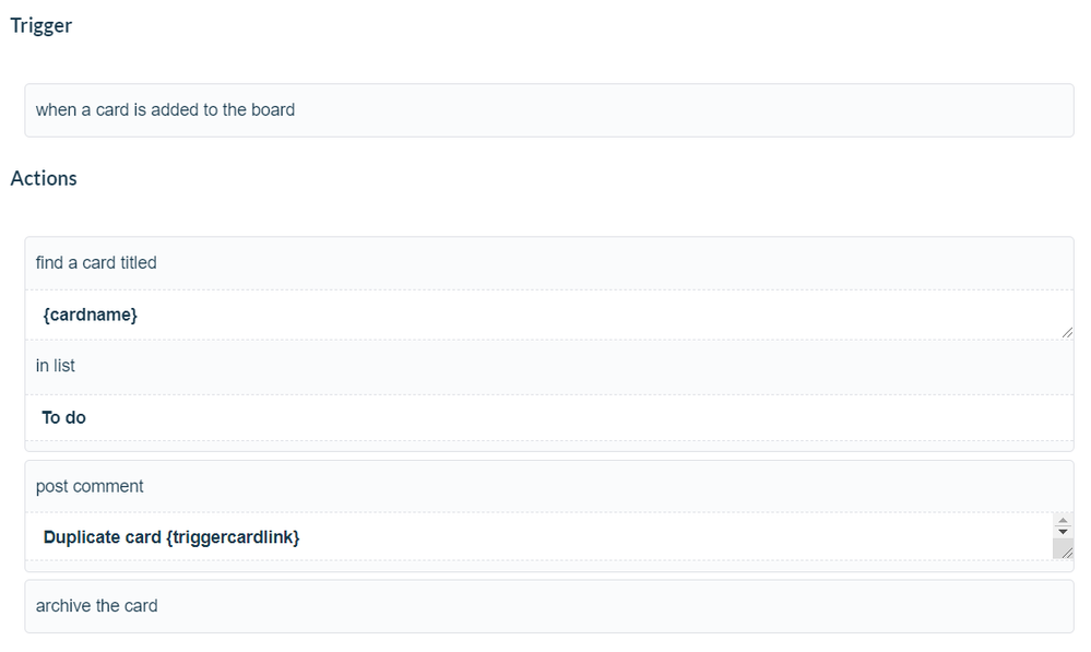

Ah, got it! I misread your question thinking you wanted to remove the "78" from the card's title. So you're basically just wanting to avoid duplicate cards, and if Trello finds a duplicate, it should archive the one in the "To do" list - is that right?
Would this make sense?
You could also add an action in there to email yourself with the card links so you can be notified when duplicate cards are added.
This only works if the duplicate cards share the same name. If you've got duplicate cards that don't share the same name exactly, it may get a bit complex i.e how do you ensure butler is looking up the correct cards and how do you avoid cards getting archived when they're not actually duplicates.

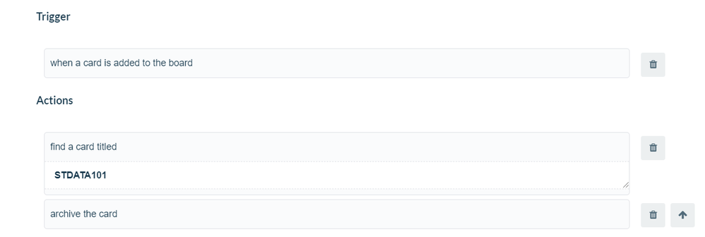

Ayden Heinig January 25, 2022
Thank you so much. I ended up simplifying it down a little bit and it works perfect. Thank you for your help. Capture.PNG
