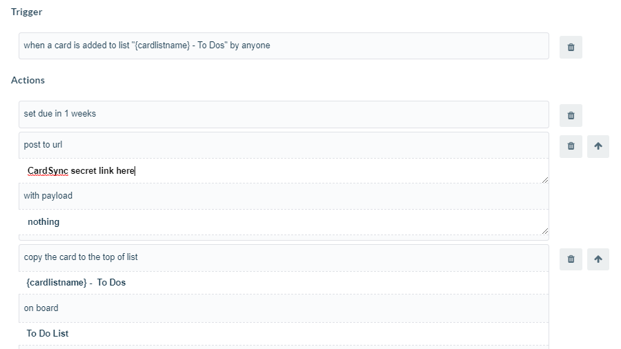

I have 3 boards (named Board 1, Board 2, Board 3) I'm trying to sync to a "To Do List" board. Each board has a list named "{name of board here} - To Dos" (the same list name is also on the To Do List board). My wildcards don't seem to work. I'm trying to:
I tried "{*} - To Dos" , "{listname} - To Dos" , "{boardname} - To Dos" but none of them seem to work. What did I do wrong?
Here's the rule I tried (that isn't working). Hope anyone can help me out!

If you use the rules without modification, in your case you will create new lists in each board titled todo.
If not necessary, I recommand you not to include a board name in a list name. It will complicate the rules building uselessly.
But, if you want absolutely conserv the boardname in the list for the first rule
when a card is added to list "{boardname} - To Dos", lookup a card titled "{boardname}" on board "technicalboard", and set custom field "MyField" to "{foundcarddescription}"
when custom field "MyField" is set to "{*}-{*}", copy the card to the top of list "{wildcard1} - To Dos" on board "{wildcard1}", copy the card to the top of list "{wildcard2} - To Dos" on board "{wildcard2}", and clear custom field "MyField"
