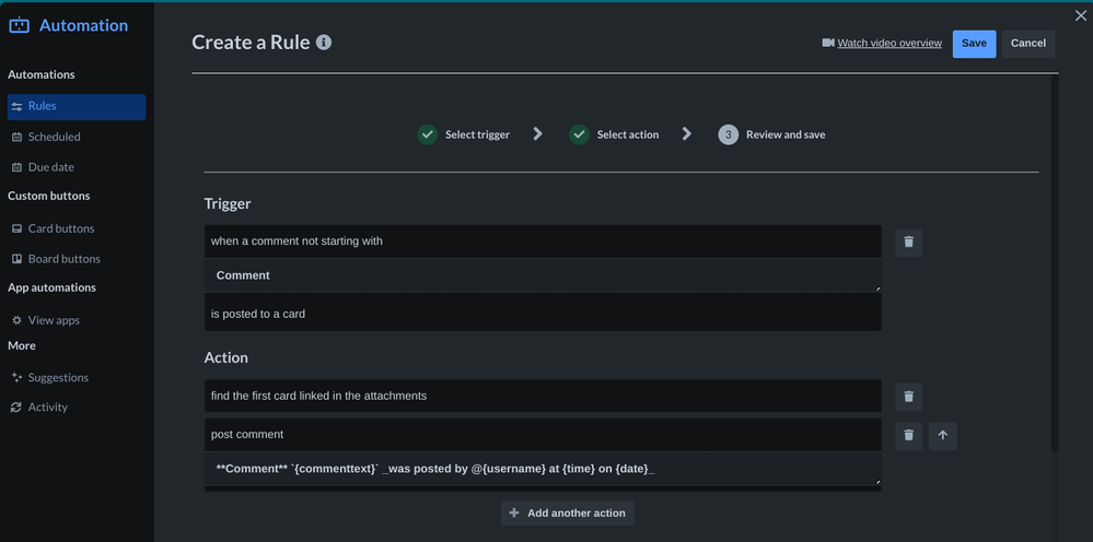

Hi @Kelly
Try this automation, enabled on both boards...
Kelly May 21, 2024
Yes, this worked like a charm! Thank you so so much! Not only for your help but also for your persistence with my problem.
(Do not forget to also put the ** in front and at the end of the word Comment in the trigger, it's so specific...)
Also discovered that there were still all kind of power-ups I once installed that still had access even though I had already removed them from the boards. This also had an effect on my automations. I didn't know this was the case at first, but you can check this in your settings in your account and then scroll down to applications. You can then revoke access there.

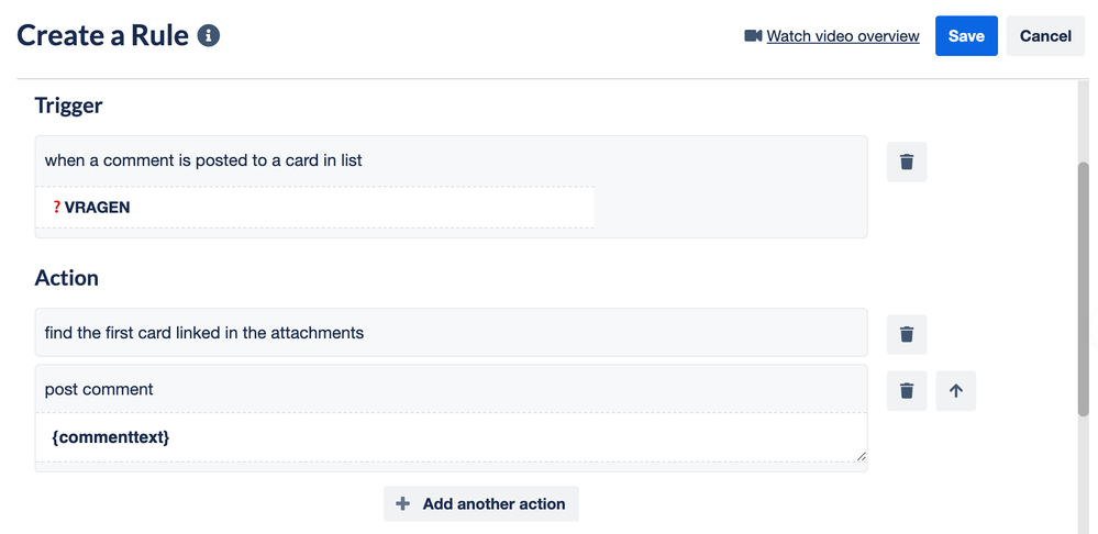

I have separate board with clients. They ask me questions in the list ?VRAGEN. When that happens the the following automation starts:
when a card is added to list "❓VRAGEN", copy the card to the top of list "?VRAGEN VAN KLANTEN" on board "Dashboard" and link the cards together
So that al the questions i get from different clients gets bundled for me on my dashboard board in the list ? VRAGEN VAN KLANTEN
Then i have the automation on the board of the client that also the comments in the card get synced to the linked card (on my dashboard). I made this in a separate automation:
when a comment is posted to a card in list "❓VRAGEN", find the first card linked in the attachments, and post comment "{commenttext}"

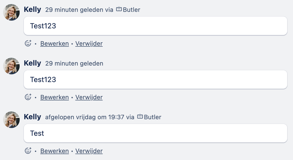

When the client now make a comment. You see this:
First her comment she made and then the one butler is posting again.

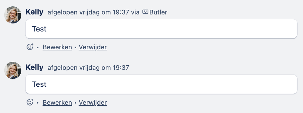

I also have the automation that my comments get copied back to the card on my clients board:
when a comment is posted to a card in list "?VRAGEN VAN KLANTEN", find the first card linked in the attachments, and post comment "{commenttext}"
And also there, when i make a comment. I get the same comment again posted by butler:
