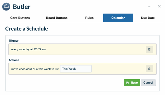

Hi Sophie,
I use these all the time - but they're under Calendar options within Butler, not rules. I do mine every Monday morning, so the 'this week' and 'next week' are actually this week and next week, not days from now because I got far too confused!
This is what mine look like:

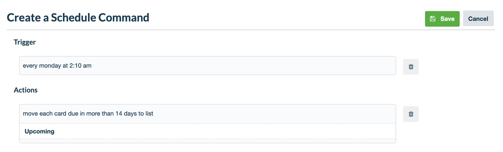

Hi there!
You could use a 'day' calendar rule here, which might look something like this:
I don't have a 'later' list, I have an 'Upcoming' list, but I would imagine your 'later' list and my 'upcoming' list are doing the same thing.
So if you ran all the others on a Monday, then you could run this one on a Monday as well and everything that was due after 2 weeks time, this would move them all into the 'later' list.
