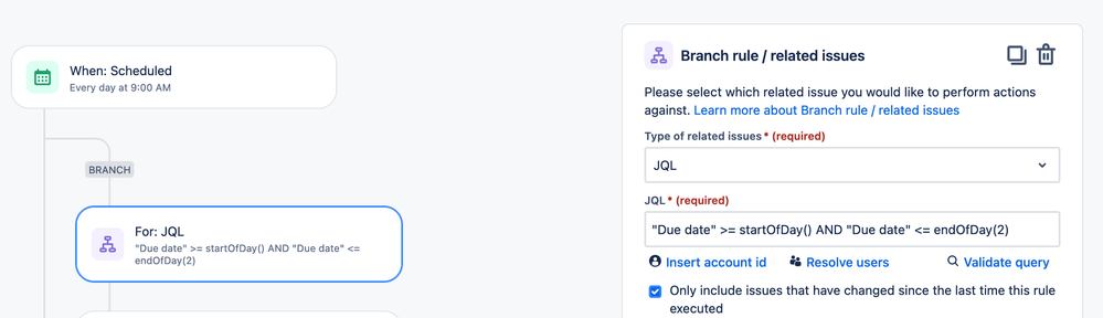

You will not be able to set a trigger on a value as triggers are set on events like values being changed. What you can do is:
1. Create a schedule trigger to run everyday
2. Get the relevant tickets using JQL as in the example below, which gets all tickets with due date in the next 2 days (change you field name accordingly)
3. Finally perform the action - email or slack.
Hope that helps!
Hariharan Iyer
February 19, 2024
Apologies, I just noticed your query was regarding Trello and not Jira. Let me see if there's a way to do something similar for Trello as well.
