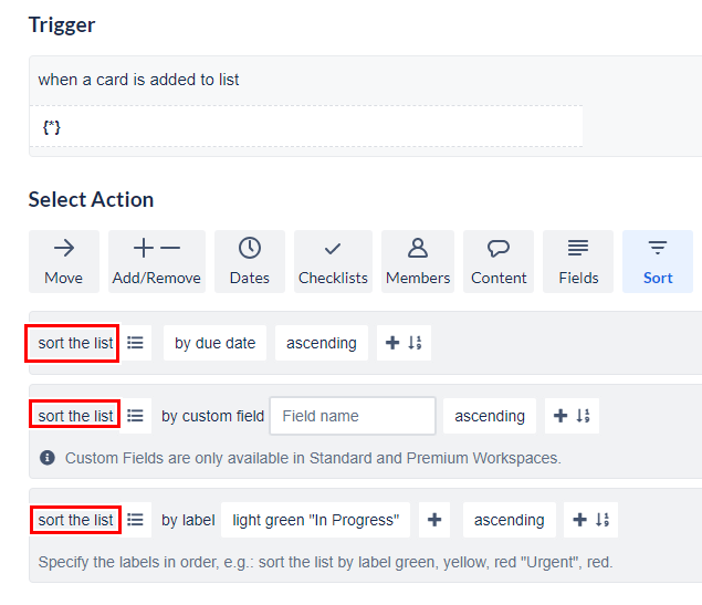

There are 2 options here.  You can replace the list by number by using a #
Your automation would be:
every day at 8:00am, sort the cards in list "#1" by due date ascending
My personal preference would be to keep my lists sorted all the time. You can do this by using a triggered automation below:
when a card is added to list "{*}", sort the cards in list by due date ascending
The {*} is a wildcard in Trello automation, this essentially means "when a card in any list"

thank you for your help, but I don't have the option of selecting sort the cards in list, maybe because I use the free plan ?
thank you
