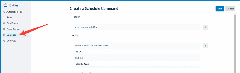

Hi Jen! Welcome to Trello :) It is possible to create a rule to copy cards from one board to another and set it to trigger on certain days of the week. You'll need to create a calendar command in Butler - something along the lines of this:
I'm not sure how scalable this option is though for a few reasons:
1. The cards on the master weekly tasks board are not synced with the original cards, so you'll need to duplicate the work across both boards
2. What happens if you add a new card during the week that's due for the same week?
3. What happens if something that is due this week gets pushed to another week?
In the end, your Weekly Tasks board might not be as up to date as you want. It might make sense to build something that's a bit more dynamic
