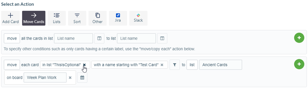

Hi. I recently started using Butler, so as the Trello folks suggest, I am using it via the Butler power-up rather than the Butler bot. The Butler bot supported wildcards in list names; however, this does not seem to be working using the power-up.
For instance, I used the command creator to make a Button Command that created this command;
move each card in list "{*}" with a name starting with "Test Card" to list "Ancient Cards" on board "Week Plan Work"
When I run the command, it runs fine--but only on the first list on the left on the board. The other lists are ignored. So the wildcard seems to be accepted, but it is not having the expected results.

The 'in list _' attribute is expecting a single list, so when you told it to find {*}, the first list it found fit all the parameters and it stopped looking.
At least for the test case, omitting the 'in list _' attribute would work exactly as how you envisioned it.
Wildcards worked fine last time I used them, just have to keep in mind that the context they're used in is (always?) for getting a singular result instead of many (there are specific Butler commands for the latter, such as the Move Each command you used)

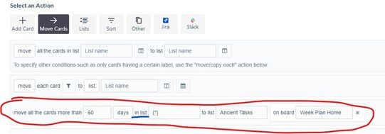

That makes sense. The problem now is that I want to make a command that will move all cards that have been on any list on a particular board for more than 60 days onto a central "Ancient Card" list. Unfortunately, the Command Creator only seems to offer a card age option with the "in list" criteria. Your excellent explanation makes it seem like there is no way to make this work. Here's the Command Creator that I need:
Do you see a way to do this with one of the Command Creator options?

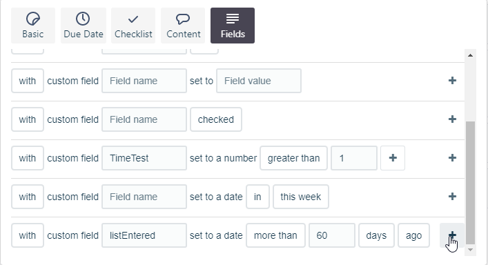

You can get the same "card age in list" functionality with more flexibility with an additional Rule and the Custom Field powerup.
(Edit: as an aside, my previous wildcard explanation is still pretty bad.. The wildcard usage below I'm guessing works because the actual trigger is the card moving, then it checks the current list fits {*}. Whereas your screenshot above first looks for a single list {*}, before checking card age. If that makes sense)
Set a Rule: When a card is moved in to list {*}, set date custom field "listEntered" to now.
Set a Board Button: Use the old Move Each command, with a filter for "listEntered">60 days ago (Should probably also add a filter for not in list "Ancient Cards" so it doesn't repeatedly trigger off of old cards)image.png
There's not a whole lot of flexibility in the card age area in general though, so it can be a bit difficult to finagle a good solution. For instance there's no way (that I know of anyways) to access a "last updated" variable. Its doable, just requires a ton of rules to cover all things you'd consider "editting" which will eat in to operations by a lot. Due Date is another potential avenue as well, but I've been using Custom Fields instead of that so not sure on that.
