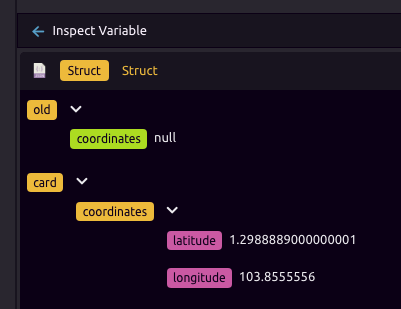

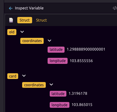

Information still via webhook with trigger on the platform I am using. Using webhook, you can get the initial coordinates and also name and coordinate changes
