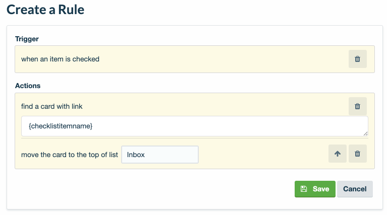

What I'm trying to do is that when I check an item in a checklist, its linked card will move to another list. When testing, I was getting the parent card containing the entire checklist to move, but I just want the child card linked to the particular checklist item to move.
I found this board with information, but I'm still not able to move the linked child card. I haven't found a way to write out the rule as is listed there either; seems like the rules builder has undergone an update, so I can't get the syntax to match exactly.

That did the trick! I tried this same thing with the exception of "find a card with link" I used "find a card titled" - obviously that didn't work though.
Thank you :)
I find this only intermittently works.
Sometimes the "checklistitemname" is a trello URL, sometimes it's blank
I tried using "checklistitemlink" and that, similarly, works sometimes, but then comes up with "" others.
A little frustrating, so if there's a way to make the link URL and checklistitemname more reliably appear with the rule, or another way to do this that I'm just not getting, I'd love to hear it.

Can you add a screenshot of the rule you have created for this use case?
