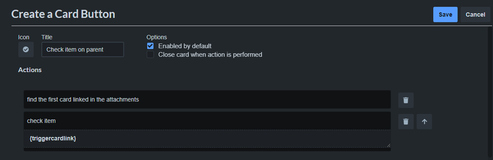

I created a rule that when an item is added to check list "Conditions" that i converts it to a linked card.
The parent card will have multiple condition items in the checklist so it may create 8-10 different cards.
I would like to create a button on the child card that would check off the item in the checklist on the parent card.
Any ideas?
Thanks for your time
Button rule, "find the first card linked in attachments and check the item "Triggercardlink"
Couple of caveats with this rule:
1) Works best if you only have 1 card linked as an attachment on the child card
2) If the child card is on a different board to the parent, the person who clicks the button would have to be a member of both.
The alternative is have a done button on the child card, which sets the due date as done, then set up a rule "when the due date is complete on a card, find the first card linked in attachments and check item {triggercardlink}"
