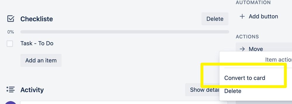

When I convert an item from a checklist to a card I want that the old and new card are linked together. For me, the following automation seems what I want to do but it doesn't work. Does anyone have a solution to do this?

@Iain Dooley thanks for your answers! But..
Is there no automation solution for "convert to card" from a checklist item and link this new card automatically to the card where I converted it from?
