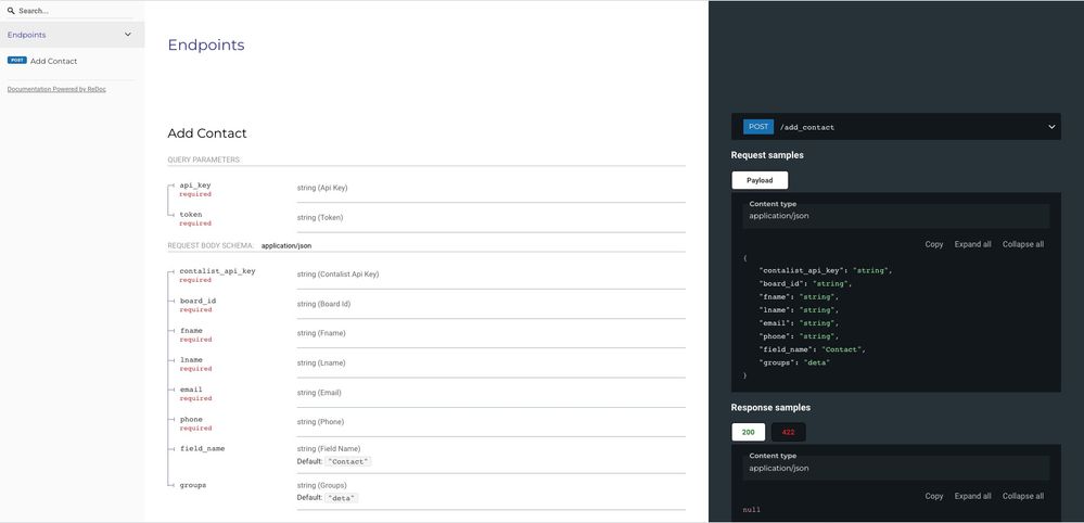

I worked with Contalist and it’s api a bit. You can consider using shortcut as a share sheet and using http request to call an endpoint which will then update Contalist.
My understanding is that when you add a contact in Contalist there is no trigger. Therefore going the opposite way will be difficult at this point. However, you can get the Contalist contact from sync card from shortcut so that you can create a contact on iOS using a short cut calling another endpoint.
This is the basic endpoint to create a card and add the contact to the card :
