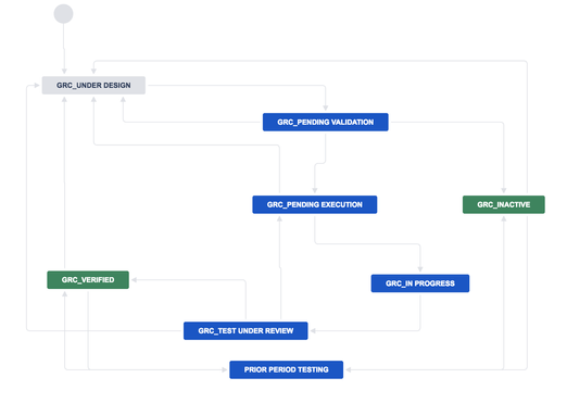

We really tried to keep the workflows simple for all the issuetypes.  The reason was that we often found ourselves clicking through workflow as a way of evidencing that work had been done - when the actual work had happened in a meeting with the business teams.  If you need to add steps to evidence approval then put them in - but consider using comments as a way to make that easier on yourselves.

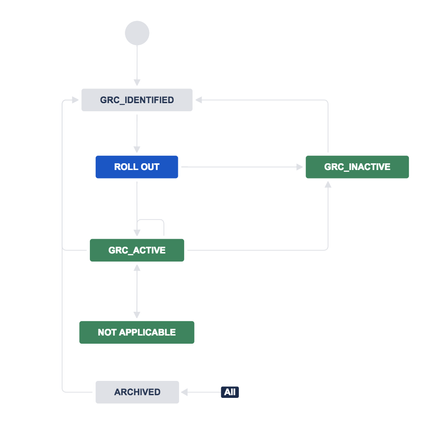

Risk and Risk driver
Policy
Standard
Control Objective
Control Activity
Control Test

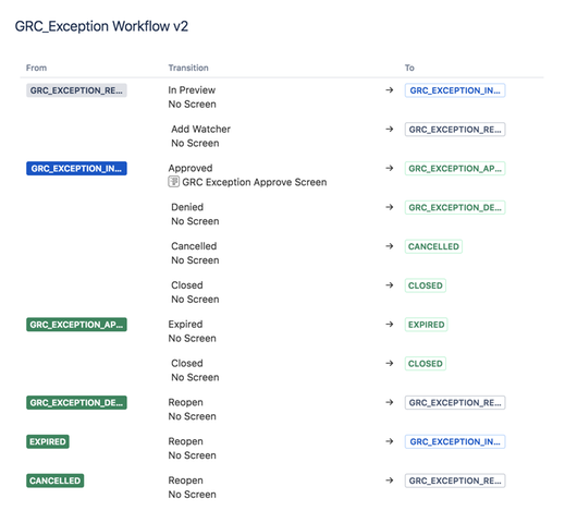

Exception

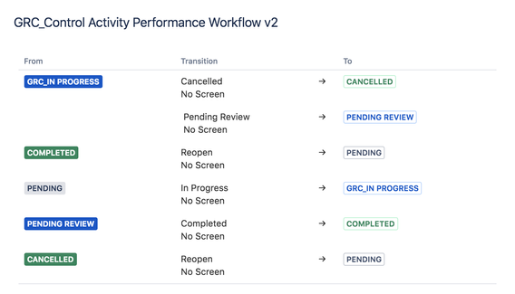

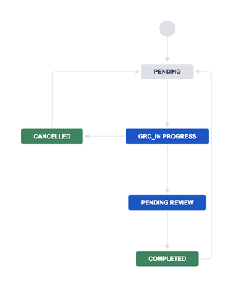

Control activity performance

GRC_Exception WorkflowApprovedGRC Exception Approve ScreenCompensating Control
