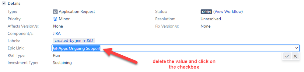

@Mike Lemmon - You should go to the user story in the Jira project and manually delete the EPIC LINK (see example screenshot). Afterward your AR plan should reflect the change.
This is assuming that you have the permission to edit the user story in the Jira project.

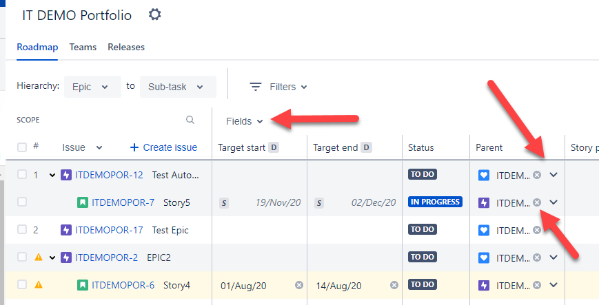

Forgot to mention that you can also do this within your AR plan. You have to expose the "Parent" field in your plan. If you don't see it, then click on the Fields button to add it to your plan.
Once you plan is showing the field column, then you can go to the user story issue and click on the "x" button to remove the link to the Epic. Remember, you will need to commit your change, so it can be pushed back to the Jira project. Otherwise, it is only local to the AR plan.
See attached image for your reference -
Best, Joseph

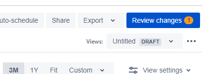

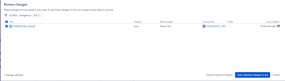

@Mike Lemmon - Remember you will have to commit the changes back to the Jira project after you remove the link in your AR plan. Otherwise the AR plan will refresh itself with what's is coming from the source. (see screenshots below)
You will also need to check if you have the proper rights (edit issue) against the source Jira project.
Hope this helps.
Best, Joseph

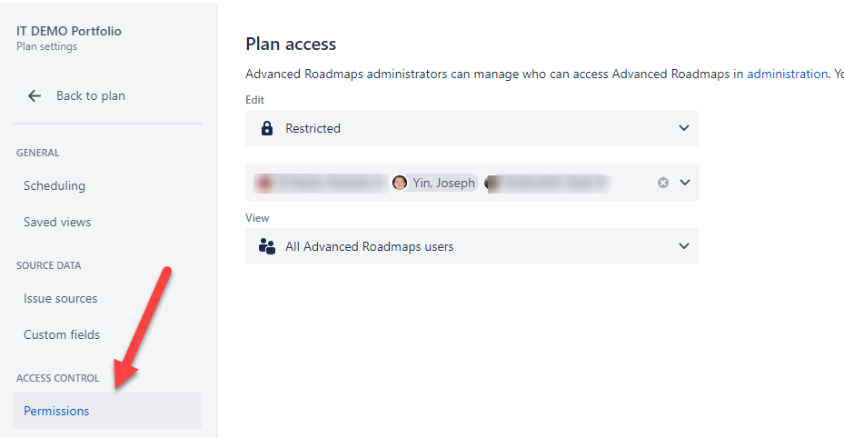

@Mike Lemmon In addition checking your permission to the source project, you will also need to make sure that you have the Edit right to the AR Plan itself. You need to click on the clog wheel symbol (on the right of your AR plan's name) and select the "Configure" option. From there you need to check on the "Permissions", make sure you are part of the users that have Edit right to the plan.
Best, Joseph
