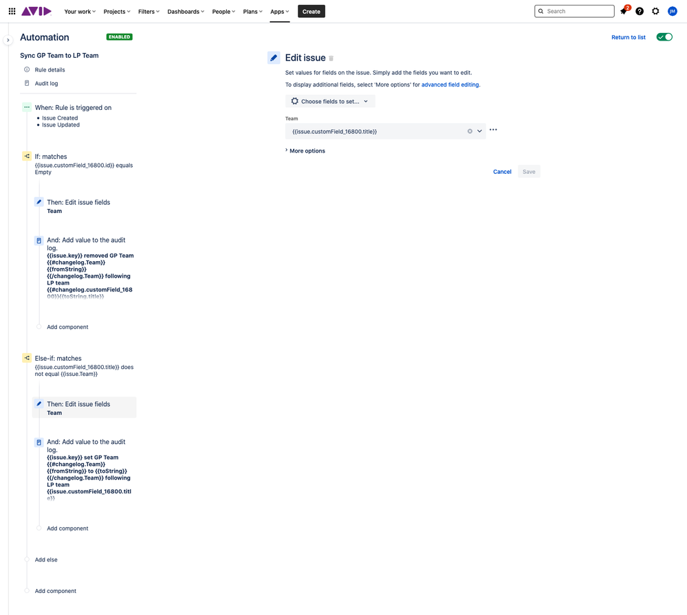

So I'm trying to work around the lack of Dashboard Gadget and Confluence Filter support for the Team field, and the best method I could come up with is using Automation to synchronize the field we previously used for Team assignment and people can use that field for filters/dashboards/etc. However, since I don't have access to the Team field as a trigger, my only option is having the trigger be set on Issue Update or Issue Create...and this is now causing my automation to run too frequently on my instance. Do you have any suggestions for my situation?
You could run it on a schedule trigger...not real time, but contains the frequency

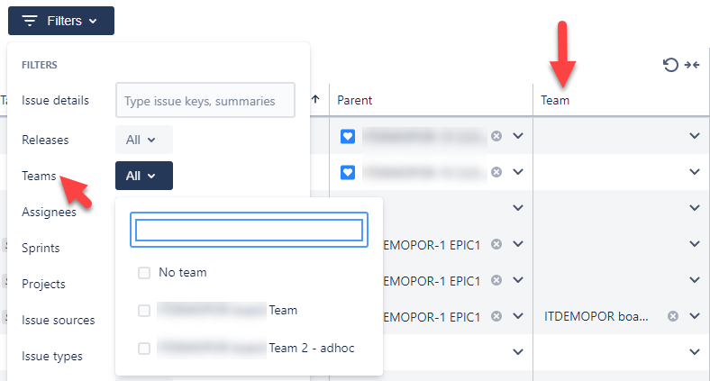

Team concept only lives in Advanced Roadmaps plan and doesn't push back to your Jira issue, therefore you cannot conduct Team filtering outside of your plan.
In your plan, you can apply Team Filtering or you can expose the Team column for your plan. Changing assignee has nothing to deal with changes in the Team field.

The "Team" field does exist in outside of Advanced Roadmaps, however you'll need to configure your issue screens to show it.
You also need to share your team (from the "Teams" tab) in Advanced Roadmaps in order for the Team name to be visible on the issue details page (otherwise it just says "Plan specific team").
Once you've shared a Team you can then add it to other plans (although unfortunately it doesn't keep metadata like members, team type, velocity, etc) in sync across plans.
You can also create JQL filters that use Shared Teams. We actually create Shared Teams for all our teams and then create filters for each team and create a board per team so each team has it's own backlog that is a subset of the work in the project assigned to that team.
