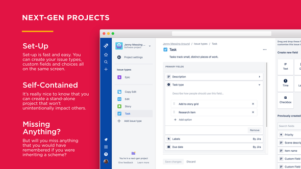

Set up was fast and easy.  I had mapped out my project on paper so it was pretty quick to set up the issue types I wanted.  I added and ordered the fields I needed right there as I was creating the issue types, creating custom fields and adding choices to my dropdowns – all on one easy screen and with no schemes to worry about.
I set up my screens at the same time that I created my first issues. Again, it was simple and intuitive. I simply clicked on Configure Fields on the Issue Create screen and now all of the fields I wanted are there.

Time will tell if those two advantages also turn out to be the biggest disadvantages of next-gen projects.  While setting up the next-gen project was certainly easy, I wonder if the simplicity itself may cause users to miss out on something. When you wade through issue type schemes, field configuration schemes, etc. you are getting the benefit of learning from those who have gone before you. Seeing the fields that are used in other projects may trigger you to think about aspects of your project that had slipped your mind, aspects that may not be relevant to you, but are crucial to other users. I’m curious to see if, as my project evolves and I make needed adjustments, it will end up looking a lot like one of the default schemes.
While it’s nice to be able to create a project knowing that you won’t mess up what anyone else is doing, it’s also implies a higher level of responsibility. If this is my standalone project, with my issue types and my custom fields, then it’s my job to get them right and to clean up the mess when I get them wrong. It will also be my job to deal with maintenance –to keep the project clean, to make needed changes, to clean up the data when garbage gets entered. Simplified maintenance is one of the key advantages of shared schemes. It will be interesting to see, as use of next-gen projects grows, if maintenance becomes an issue. Atlassian has said that they will shortly be providing the ability to extract next-gen project settings into their own template, and link two or more projects' settings together. (However, they also say that if you want to share configurations, it's best to go with a "classic" project.)
