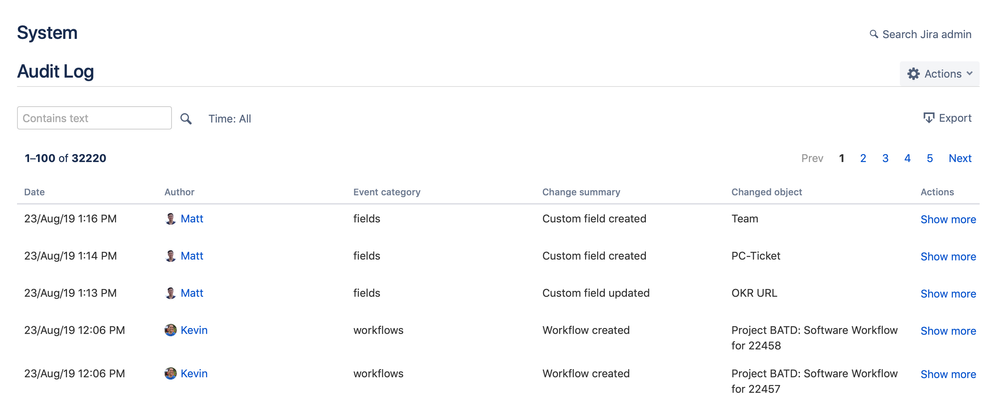

  • Audit Log: Jira Settings → System → Audit Log. It displays the configuration and changes made by the admins.
Image source: Atlassian Support

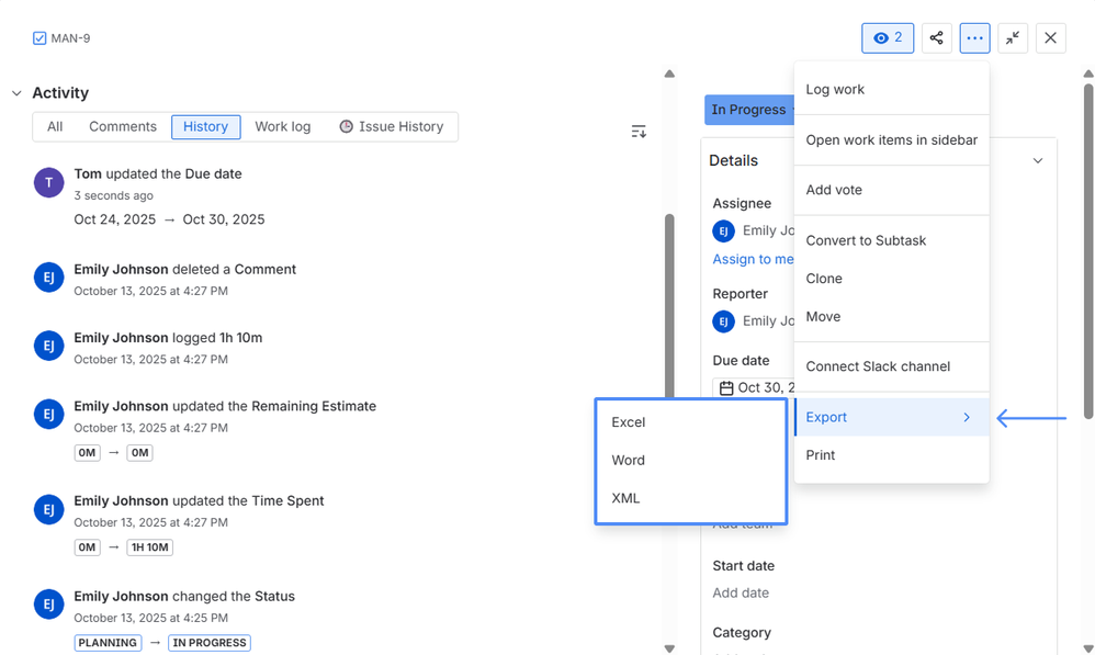

  • History Tab: accessible in each work item. It displays changes, such as status updates and comment edits.

  • Audit log (admin-level): Go to Settings → System → Audit Log, filter by date, and Export CSV.
  • Work item history (user-level): Open the needed work item and go to the History tab to view field changes. To export the work item data, go to Actions and choose Export. Notice that you’ll be able to export the current work item’s field values, not the whole history of changes.

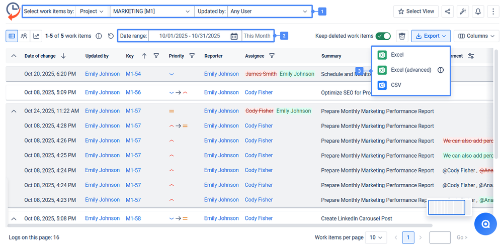

How to start using Issue History for Jira app:
  1. Install the app from the Atlassian Marketplace and open it from the Apps menu.
  2. Apply the required filters (project, date range, etc.).
  3. View a table with all historical changes related to work items.
  4. Click Export → Excel or CSV.

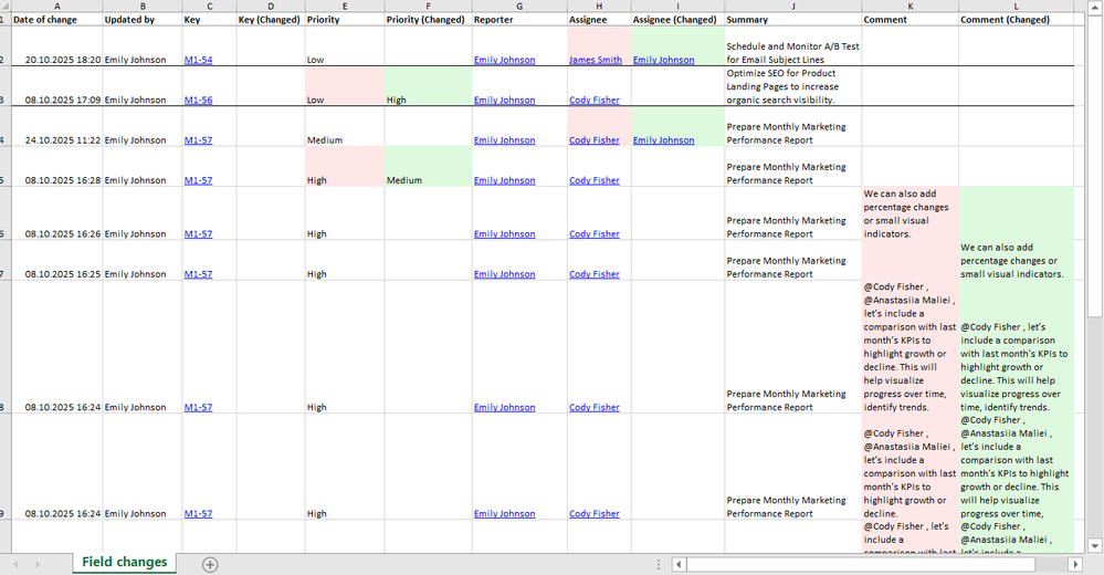

In just a few steps, you’ll have a complete audit-ready report that you can share with managers, auditors, or stakeholders.
