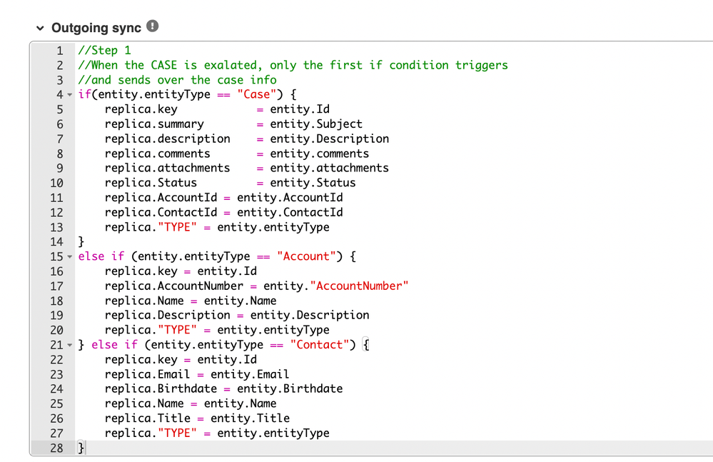

Step 1: Outgoing Sync, Salesforce
  • Line 4: Here, the first ‘If’ condition checks whether the entityType is ‘Case’.
  • If yes, then Subject, Description etc for the Case is copied into a replica to be sent over to Jira.
  • Line 13: replica.“Type” carries the type of the Salesforce record, for instance, Case, Account or Contact. This is used at the Jira end to recognize what type of entity is coming over.
  • Line 15 and Line 21: The next 2 if conditions are to send specific Account and Contact related information.

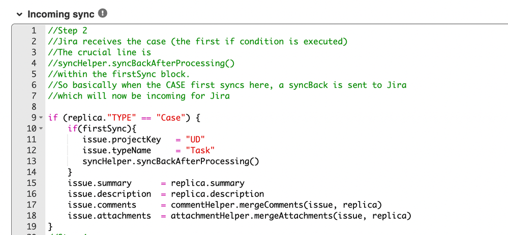

Here, you will check if the entity from the replica is ‘Case’, if it is and it’s the first sync, then you create a ‘Task’ in Jira.
And then we call:  syncHelper.syncBackAfterProcessing().
This is a helper method the Exalate API provides. When it’s the first sync, this method syncs back to Jira, so there is an incoming sync for Jira to fetch the Contact and Account information from Salesforce.
Note: You can also have a look at the other helper methods provided by the Exalate API.

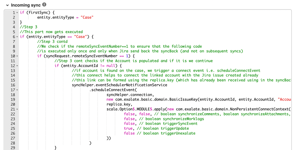

In Salesforce, if it is the first sync then a Case is created. Do remember that this is completely customizable, you can create any other entity if you want.
Line 6: If the entity type is Case, then proceed with fetching the Account and Contact information
Line 10: The value of the syncRequest.remoteSyncEventNumber is checked to see if it’s equal to 1. If it is, then it ensures that the code that goes next is executed only once and not on every subsequent sync.
Line 12: Checks if there is some Account information to be fetched (i.e it’s not null).
Line 16: Executes the scheduleConnectEvent method which connects the linked Account from Salesforce with the Jira issue already synced with the Case, and doesn’t create a new one. It uses the replica.key from the Jira side to form this link. This key is already received in the syncBack transaction.

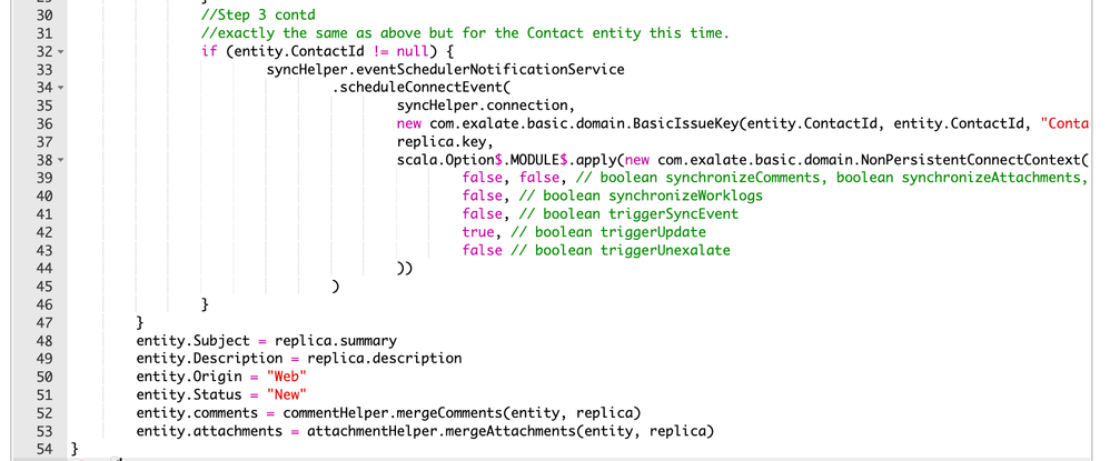

The same set of code applies to fetching the Contact details as well.

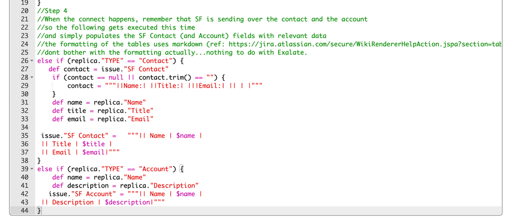

Now coming back to the incoming sync on Jira, it’s time we display the fetched Account and Contact details.
As seen, the details are displayed in custom fields called ‘SF Contact’ and ‘SF Account’.
Line 26, 39: Check if the type of entity received from Salesforce is Account or Contact and depending on it, the details are displayed further.
Line 36, 37: Name, Title and Email of the Contact are displayed.
Line 42,43: Name and Description of the Account are displayed.
Additional fields from both these Salesforce records or some other Salesforce record in itself can also be displayed this way.
Note the ‘|’ and ‘||’ used here are just to display the data in the form of tables. It has nothing to do with Exalate.

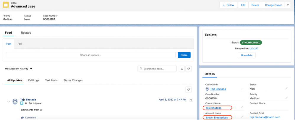

We start by creating a Case in Salesforce and assign a Contact and Account to it.
Then sync it over to Jira (either manually or through triggers).

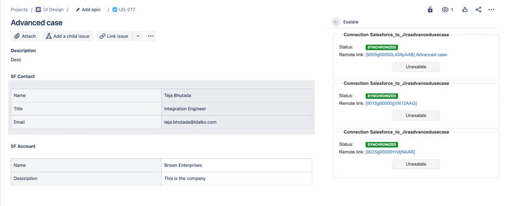

In a short while, under the issue created in Jira you can see the Account and Contact related information being displayed under the 2 custom fields in Jira in the form of a table.
Open the Exalate panel on the issue view and you can see the Account, Case and Contact sync status and also their respective remote links.
