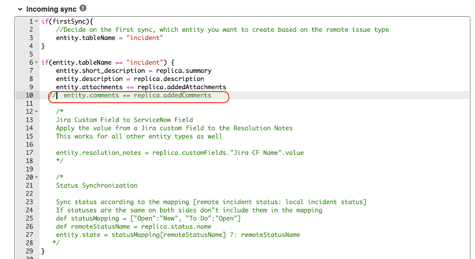

Here, the line that deals with comments on the ServiceNow side is: entity. comments += replica.addedComments
This line simply syncs the comments from Jira to ServiceNow as it is. We want to modify this behavior. So we comment it out.

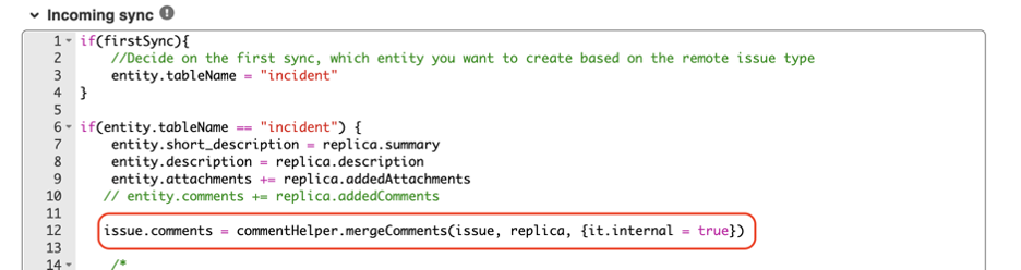

And add this line.
We use the mergeComments method of the commentHelper class that Exalate provides to merge the comments on the ServiceNow side. The thing that does the magic is it.internal=true at the end. This allows the comments from the Jira side to be treated as internal comments on the ServiceNow side.
