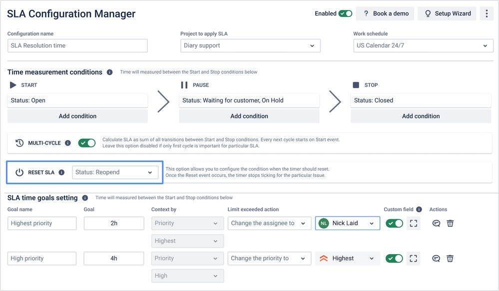

💡 Pro tip:  Identifying the exact reason why an SLA didn’t stop can be incredibly time-consuming, especially when you're combing through workflows, custom statuses, and issue histories manually. That’s where SLA Time and Report for Jira becomes your trusted helper.
With this app, you can instantly visualize each SLA cycle, see exactly when the timer started, paused, or should have stopped, and spot misfires in seconds. Even better, it offers a built-in “Reset SLA” feature, allowing you to quickly correct SLA behavior on affected issues without touching the workflow or writing complex automation rules.
Whether you're fixing one ticket or cleaning up a whole queue, it's the fastest way to restore SLA accuracy and regain control over your support metrics.

💡 A smarter alternative: Let the app do the work
SLA Time and Report for Jira takes the guesswork out of SLA troubleshooting:
  • Instantly visualize the full SLA lifecycle for any issue.
  • Quickly identify exactly where the stop condition failed.
  • Use the built-in "Reset SLA" feature to correct timers in just a few clicks - no workflow edits, no automation hacks required.
Whether you're fixing one SLA or auditing dozens, it's the fastest, most transparent way to regain control and restore trust in your metrics.

✅ After: Visual debugging and quick fix with SLA Time and Report
With SLA Time and Report, you just:
  1. Open the issue in the app
  2. Instantly see the SLA timeline, including exact start and stop points
  3. Notice the SLA hasn’t stopped after “Resolved”
  4. Use the Reset SLA button to stop it or apply logic-based corrections
Even better? You can filter and batch fix similar issues across your queue, using visual indicators and SLA filters like:
  • SLA Status = In Progress
  • Final Status = Resolved
