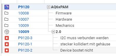

We built a small demo project in Jira using hardware, firmware and mechanical components and added a version 2.0.
We created a program in BigPicture from that Jira project - we couldn't get BigPicture to display the Gantt as expected:
While another gantt plugin (which has way less options than BigPicture has) displays the project as we exprected:
How can we make BigPicture displaying the issues as childs of the components as childs of the version as a child of the project?
The structure is enabled (as well as components sync is) and in the order project -> version -> components -> tasks
Can you help us here?

Hello Nick,
As I mentioned in my previous message there are some cases that structure builders are conflicting. It's not possible to create structure Version >> Component >> Task, because conflicting structure builders are enabled and your tasks will be nested under only one of the builders.
Components are subsections of a project used to group data while versions control the scope of the release. Components and versions used together will create separate branches in the task structure. Depending on the order of the structure builders, an issue once nested under one of them will not move.
