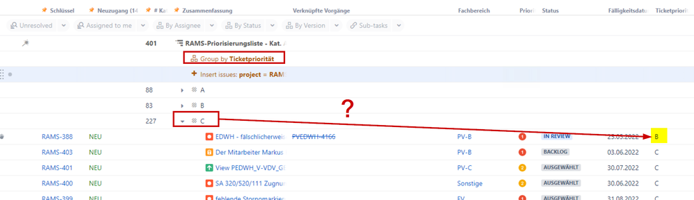

Radim Drinka BS
June 1, 2022
Hi David,
the customer finds this idea good, but we are facing some funny thing:
The setup:
Any hint what we are doing wrong?
Regards
Radim
Like Dave Rosenlund _Trundl_ likes this
David Niro
June 2, 2022
Hello @Radim Drinka BS ,
Glad to hear the customer likes the idea!
From your screenshot, I can see the hand icon next to RAMS-388.  This indicates that the issue was moved here through Manual Adjustments.
Manually adjusted issues ignore generators and can be placed anywhere in the structure arbitrarily, which is why you see it under the wrong group.
You can Undo Manual Adjustments by moving the issue back to its original position, or by disabling them for the entire structure.
I would recommend disabling them for the structure.  Since you are now grouping by a field, you can move issues between groups to change the value for the field.  If the customer is also looking to move issues up and down the hierarchy within the group, I would recommend using a Sort by Rank generator.
Please let me know if this helps!
Best Regards,
David

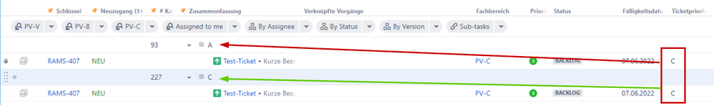

Radim Drinka BS
June 7, 2022
Hi David,
we have created a ticket ("C" is a standard value after creation) and the structure inserted the ticket as "duplicate":
The setup is as proposed.
What can be the reason?
Cheers
Radim
David Niro
June 7, 2022
From the screenshot, I can see that Manual Adjustments are still enabled for your structure.  Please follow the steps for Undoing Manual Adjustments to correct the duplication.
Best Regards,
David

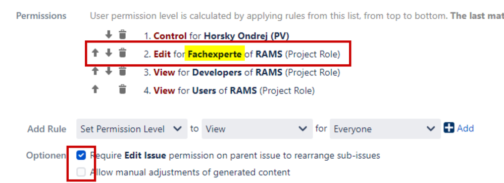

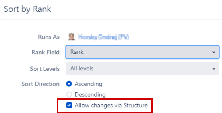

we still have one issue. There is a role in Jira and users in this role have the edit and schedule issue permission - so they shoud be able to change the rank. However - they can´t reorder the items in the structure. What can be the cause for this?
Radim

Does the user have Edit access in the Structure Permissions?

Also, it would be worth checking that the Sort Generator has the "Allow Changes via Structure" option enabled.

Radim Drinka
June 27, 2022
Hi David,
here are two screenshots that should address your points:
Cheers
Radim
David Niro
June 28, 2022
Hello @Radim Drinka ,
Thank you for the screen captures!  The first one may offer the cause.
The way Structure Permissions work is that the lowest permission on the list takes precedence.
It may be that the user who is unable to reorder by rank is part of more than one group.  Since the View permissions are at the bottom of the list, this user would only be able to View the structure.
We generally recommend putting the lowest level permissions at the top of the Permission list and the highest level permissions at the bottom.  This ensures that users who are part of more than one group have the higher level set of permissions.

Radim Drinka
June 28, 2022
Hi David,
after rearranging the permissions the ranking seems to work.
